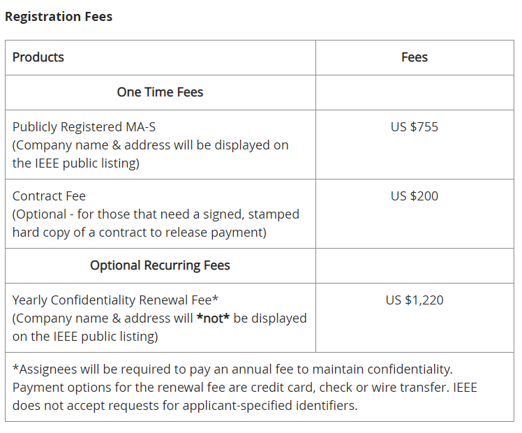

Yes, you need to buy mac address from IEEE or get other way.
You can purchase the MAC address types MA-S, MA-M, and MA-L from the IEEE.
This is Registration Fees of MA-S. You can use a 28
Please refer to link.
https://standards.ieee.org/products-services/regauth/oui36/index.html
