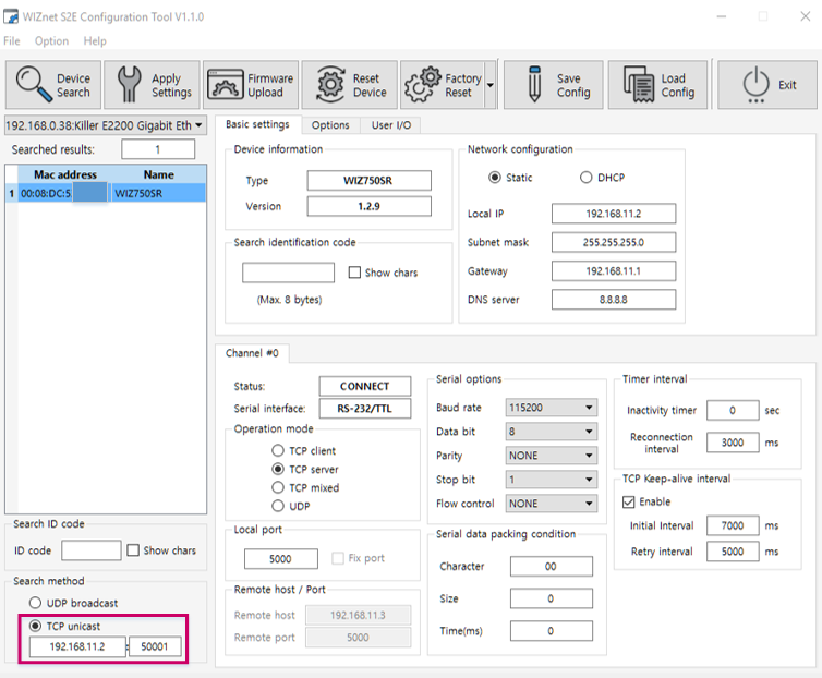

The “tool 1.4.4.1” is for WIZ107sr or WIZ108sr.
If you use the WIZ750sr series, you must use the WIZnet S2E Configration Tool V1.1.0 as Configuration tool.
There are two methods the UDP broadcast and TCP unicast for product search method.
In your case I recommend you use TCP unicast method and you just enter your product IP and port.
Configuration Tool Download : WIZnet-S2E-Tool

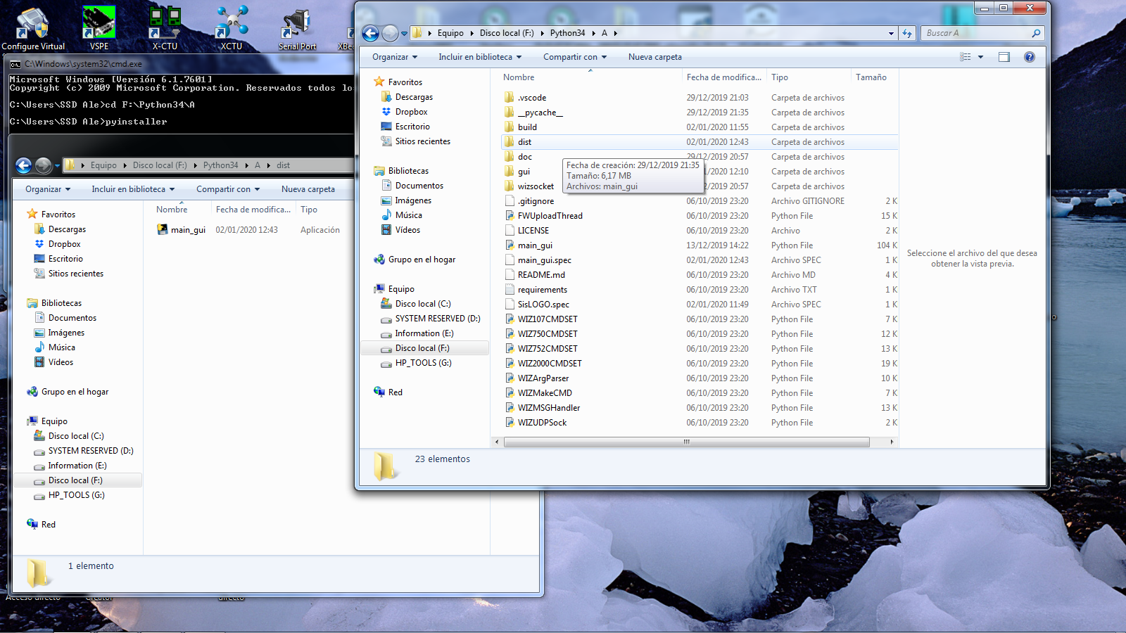

I wanted to add some things. But it is not very clear to me if I only have to ask you to compile (genere.exe) only 1 file to the PYINSTALLE main_gui.py program (this one?) And call all the others .py to compile?
Python (pyinstaller) generates a main_gui.exe
but when you execute them you do nothing.
I see that I generate all the folders (attached folders) but it doesn’t work.
Any guide?

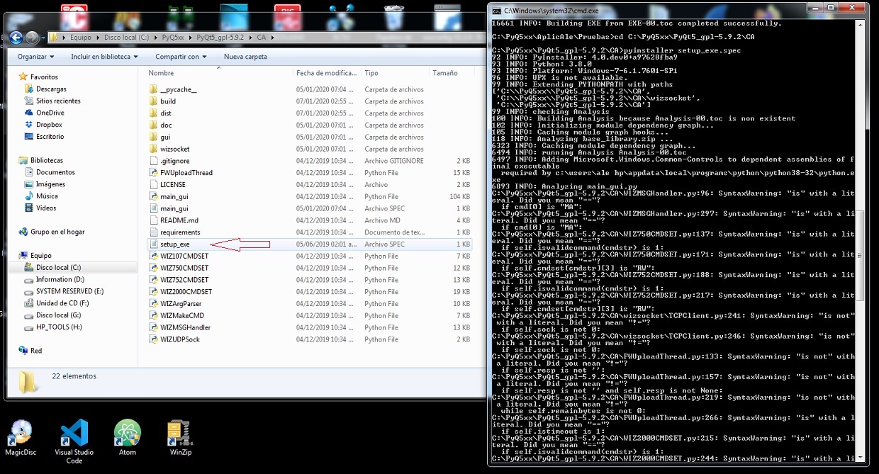

RE: Wiz750xx conexion TELNET
by WiznetSis ·
Cheers
I send the evidence.

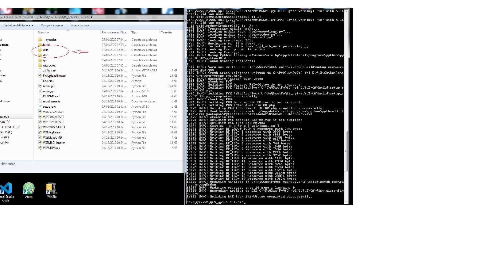

win7 (64bit) / PyQt5_gpl-5.9.2

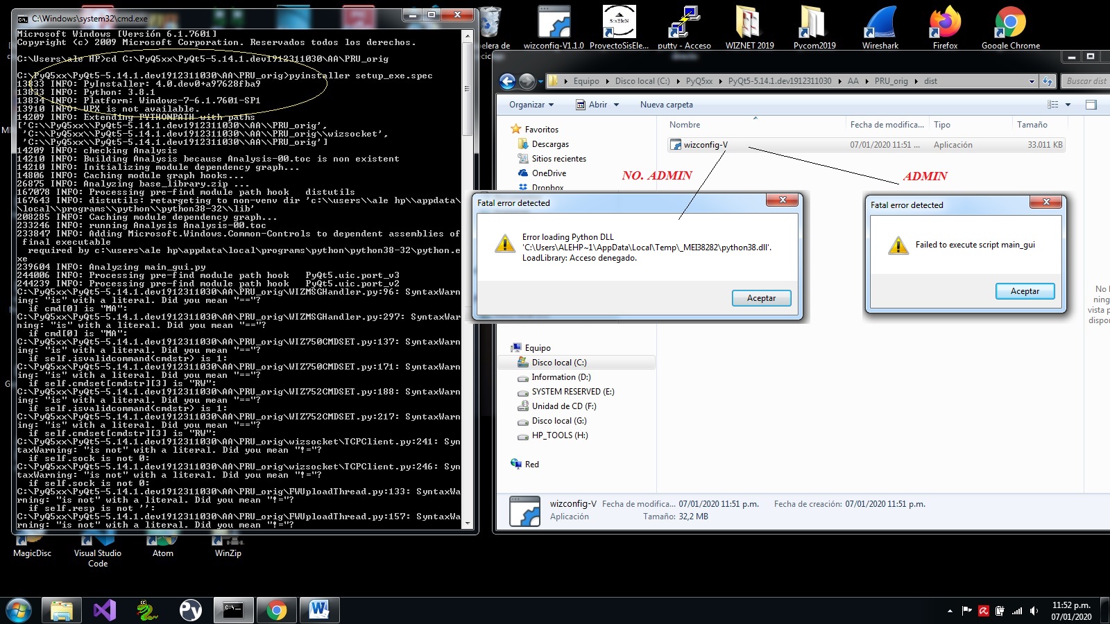

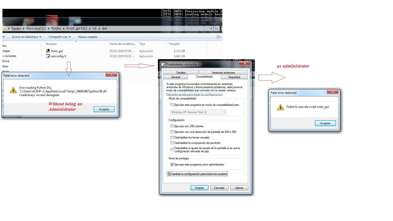

compile but at the end when executing .EXE gives the following errors:

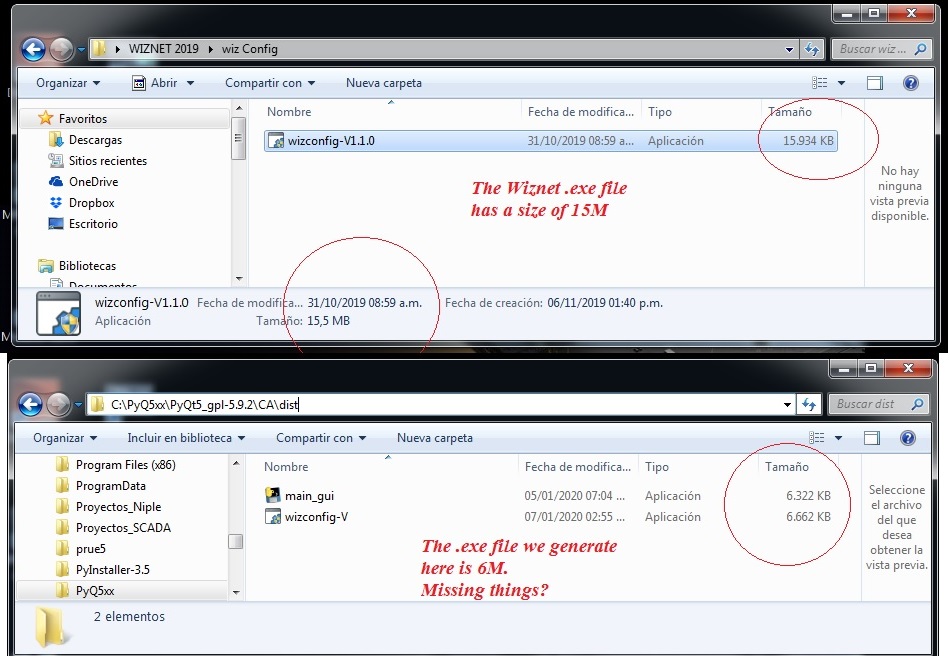

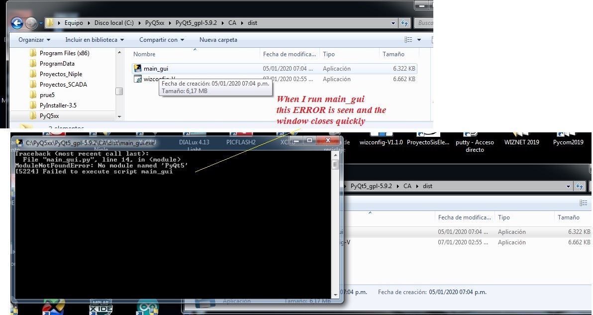

by WiznetSis ·
Otros Datos

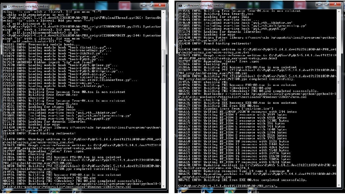

by rena ·
I think old components are affected. (build directory)
And did you install required packages?
(When I tried to install pyqt5-5.9.2 with python 3.8.1, I got error.
So I installed latest pyqt5(pyqt5-5.14.1) for python 3.8.)
Please try to below.

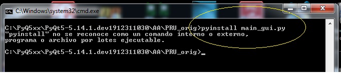

Before creating the exe file, first check whether the program is running using the command below.
by WiznetSis ·
NO FUNCIONA.
Give the same ERROR with the installed versions
Could you send me in a .zip the files that you run, or where I download them?
to be able to execute exactly all the files
Gracias

by rena ·
Not pyinstall → python
This is for check python code works well.
