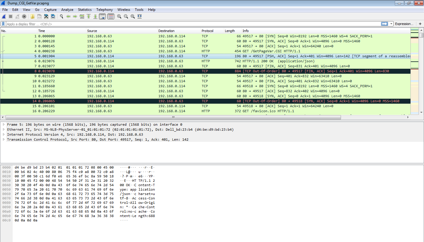

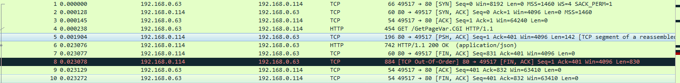

I started to see what was going wrong first caught retransmissions.
192.168.0.114 is wiznet, I fill the entire packet into the socket and give the send command why does it send the packet 2 (3 times) splits it into 3 segments? pack (5,6,7) and why send pack 8 ?
This is a json request dump 3 times

Your server (.114) appears to send the response header (HTTP/1.1 200 OK) after the response body (142 bytes). They should be in the opposite order. Afterwards your server starts to close the socket by sending (FIN/ACK). The client (.63) responds to the body or header with an ACK (you may have missed the other ACK that should’ve been there due to slow sampling on your WireShark machine; if so, that’s the likely cause of the ‘out of order’ message.). Then the client sends a (FIN/ACK) to acknowledge the close socket request.
I’d reverse the order in which the response header and body are sent, and don’t close the socket if you want to continue to use it .

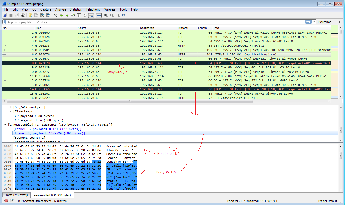

No, no, everything is correct with the order, the heading is sent first, then the body. I don’t know why Wireshark in the info column displays like this
I open pack header (№5 196 byte):
In this case, wiznet was connected to the computer via cable directly without switches and routers.
RE: Socket is stuck in FIN_WAIT (0x18) state.
Wireshark shows:

by Maksim ·
You about pack 5-7 ?
