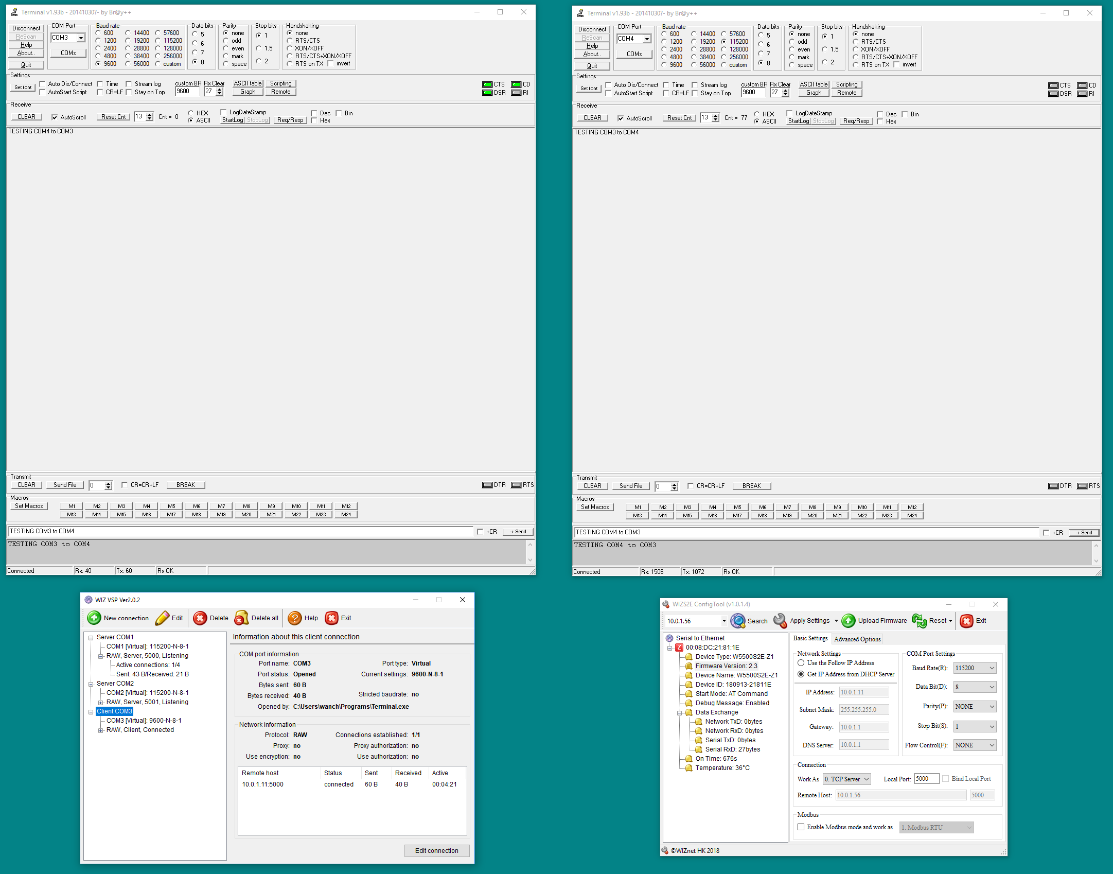

Would you mind to provide a screen capture like below showing your testing configuration and with your error prompt shown?
WIZVSP client COM3 to W5500S2E-Z1 COM4

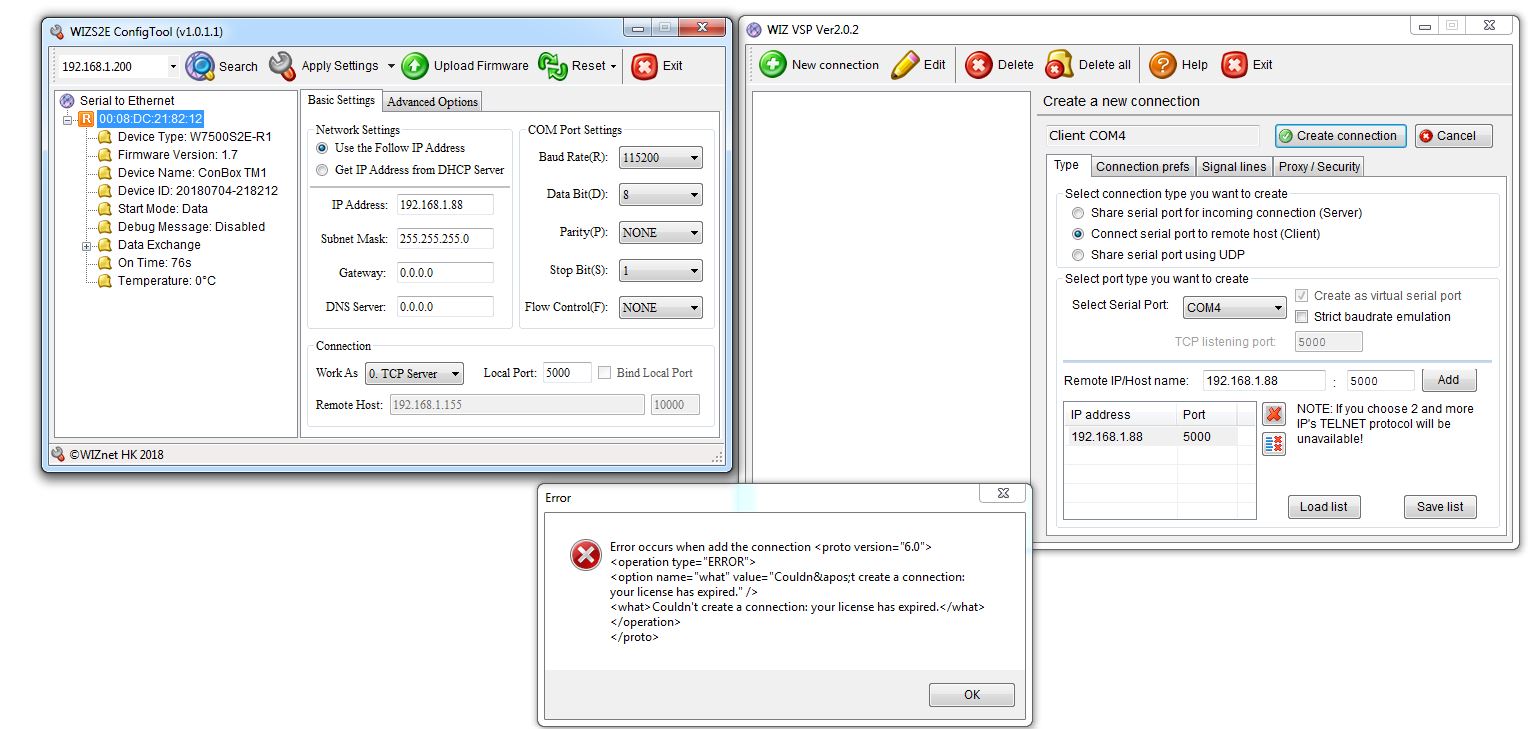

In fact I can not create a new connection.
Previously created connections from the two Wiznet modules that were properly worked were missing.

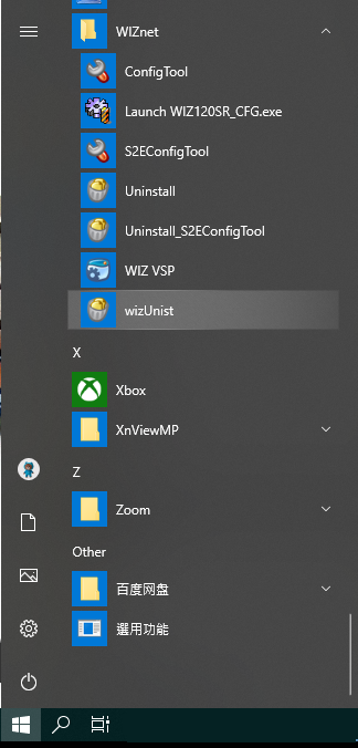

If problem persist, please remove the software by running the following program in your start manual.
Then, you can install the WIZVSP again for testing.

I’ve tried everything but without results. After that I installed everything on another computer and there it is ok. So the problem is with my laptop. As I think the license refers to the Eltima Serial to Ethernet Connector service (or sec_service), I tried to delete everything I could from a registry with Eltima text but did not help it either. Of course before that, I have uninstalled all Eltima trayal software. Finally I found in the C: / Program Data / Eltima folder … found the Sec.act file and after deleting this file and reinstalling Wiz VSP everything works OK.
