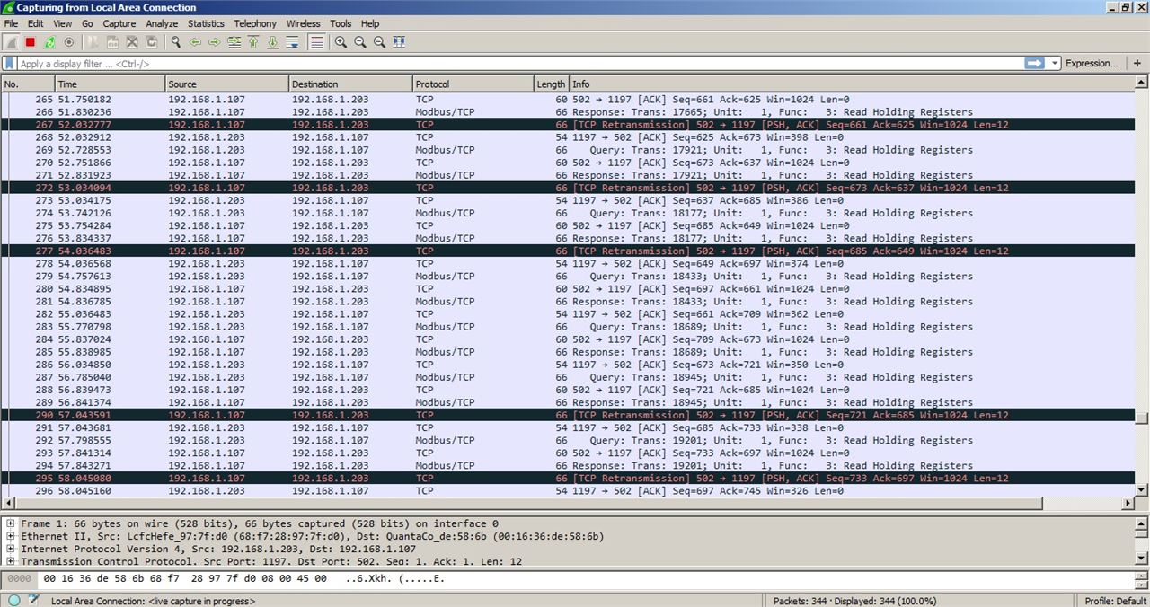

Additional retransmission Data

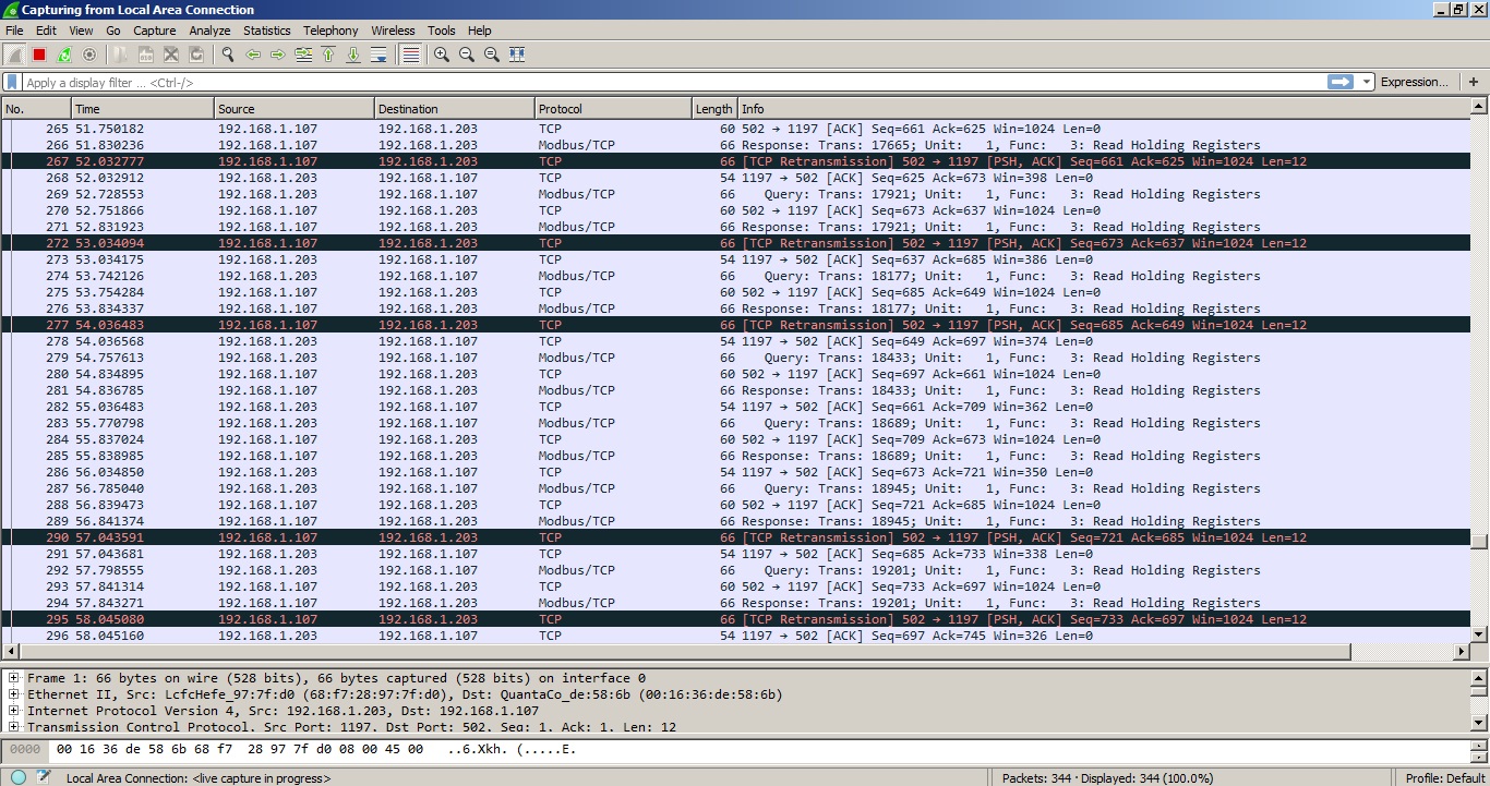

Hello Ugeny,
Find file.

RE: Additional retransmission Data
These retransmissions do not harm the data flow, they only create some overhead in the packet exchange, so the issue should not be critical.
But if you really wish to do something to make these black entries disappear from the Wireshark output, you have two options:
