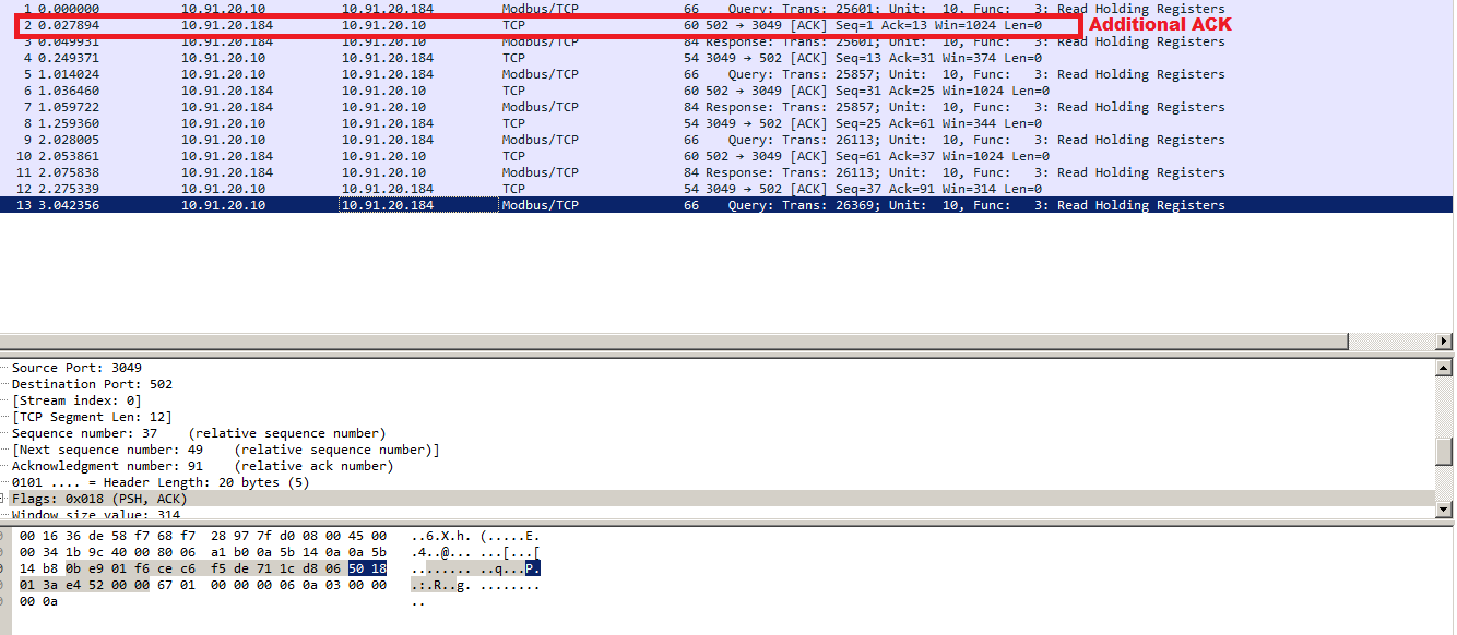

I do not think that RECV command triggers W5500 to send any user data within ACK packet.
If you mean that W5500 sends your data with PSH/ACK packet, then it is normal.
Which exactly “additional” ACK? Provide the Wireshark log and point to the entry you want W5500 not to send.

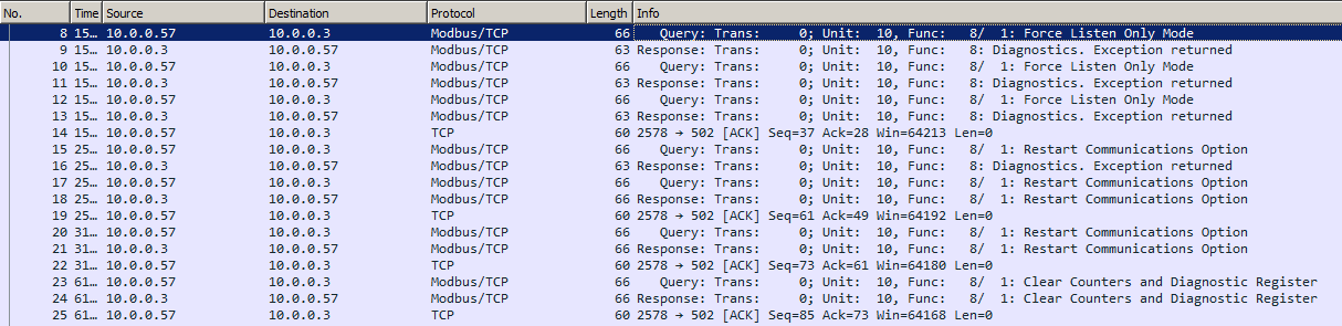

Thanks for prompt response. Find my wire shark packet.
RE: RE: Additional Ack
This ACK is related to the RECV command and notifies remote device that it can send more data and scrap data it already sent up to data being acknowledged.
Next packet is triggered by the SEND command, and it contains the user data.
I am afraid you can not combine these packets because one is related to incoming data, and another is related to outgoing data.

Is it possible to response in attached way?
You can achieve it in two ways:
In your example above I bet network nodes involved are having TX/RX buffers of 64KB, W5500 can have max 16K. If your software would track buffer replenishment, and issue RECV command only when RX buffer has less than 2*1460 bytes, then you will get similar picture as above with only few “additional” ACKs, but then your application may suffer in performance.
