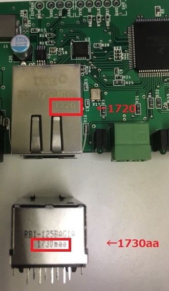

I bouth the it from other shop.
I checked the different point.
1720-> it’s not working and different the datasheet.
1730aa-> it’s working and same the datasheet.
I think that 1720 is old model , and it changed the pinout.

1730 and 1726 must be manufacture timestamp, both devices must relate to the same datasheet. It may happen that 1720 batch is just failty. Did you try measuring voltrop on the related pins using multimeter in both direction to see if it has any diode behavior?

Yes, I checked leds both directions, but it’s not working.(1720 lot numbered parts)
and I tryed reverse directions(this is not same the datasheet).
it’s working true.
