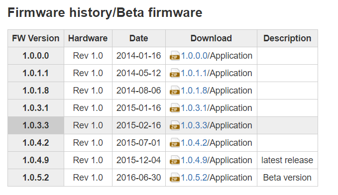

According my research (1.0.3.3 fw) they have 3 separator “,” and 4 field.
Best Regards, kzsolt2

But “Official Latest firmware release”.
I have no chance to use histor/Beta firmware.
kzsolt2

First you wrote response to SSEND is:
Then you wrote response to SSEND is:
This mean the first response is of firmware 1.0.5.2, the next is resonse for firmware 1.0.3.3?
If yes then upgrade from 3.3 to 5.2 is make the MCU code useless, because the different number of the fields.
kzsolt
