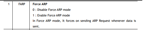

The w5500 has a force ARP mode.
It is a mode to transmit ARP request every packet transmission.
You can enable/disable Force ARP mode using the MR register.
I recommend a disable it after updating the MAC address.

I will try to activate this bit each 15 seconds, send a packet and then deactivate it again.
RE: RE: W5500 ARP Table
by fjdepedro ·
This work for me. Each 15 seconds, before sending an UDP packet, I activate bit FARP in MR register. After it, I send the UDP packet and then deactivate bit FARP. It is not necessary to close the UDP socket.
Now, using WireShark, I can see an ARP request every 15 seconds.
