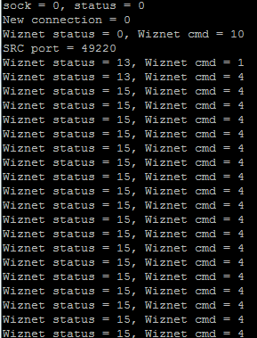

i wrote w5500 driver, TCP client and server, it works perfectly, but sometimes connection process took too long time, debugging log shows that SYN packet is transmitted (0x15 status) ,
what might be ?

socket status, and second is command
here is log, frst is a

Ok, so now time for Wireshark to see what is going on the network. SYN packet requires ACK packet, and looking at response (or prove the lack of such) may help. In your case, if it is possible, it would be good to install Wireshark on the server so that you can see activity at its interface related to this connection attempt.
First I would prove that server actually responds with SYN/ACK packet in case W5500 is hung in 0x15 state. If it does but W5500 is still in this state, it may happen that packet does not reach the chip.
