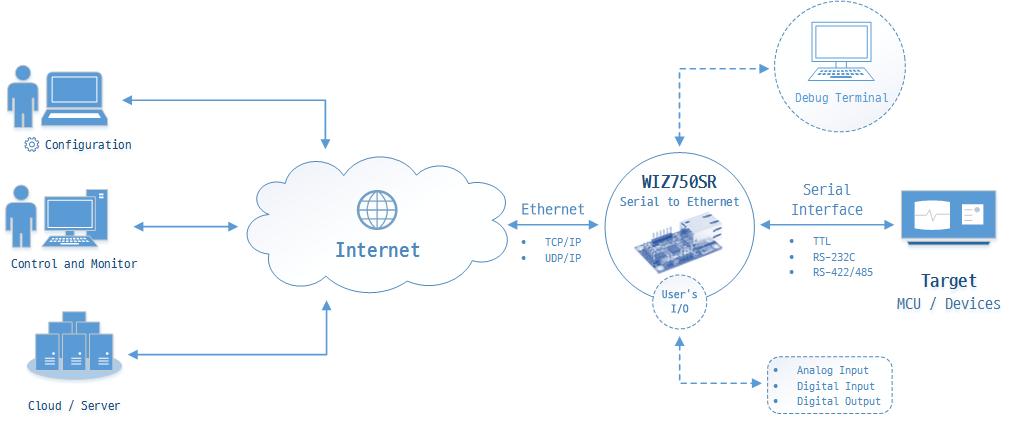

Hi, @BorisPokutinsky
You can control the settings of destination IP address, port number and etc. with the configuration tool or serial command(and by the Ethernet network). And our hardwired TCP/IP stack in chip automatically handles packet encapsulation to send/receive payload to its destination.
Below link will help you.
This link is the user’s guide for WIZ750SR module which is the hardware and software compatible with WIZ107SR product.
https://wizwiki.net/wiki/doku.php?id=products:wiz750sr:usermanual:start
