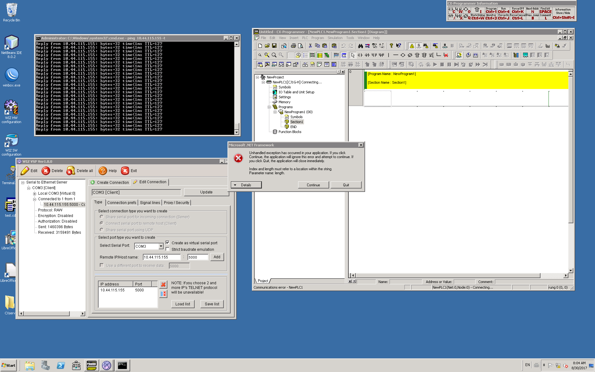

I reinstalled the WizVSP and did another test run, but after couple of hours, it crashed again with the same message:
There are another programs installed on the server. Mainly Omron and Mitsubishi PLC programmers and Scada systems. We use this server for accessing PLCs. During the last test run, only the CX-Programmer was running, communicating with the PLC over WizVSP (COM3)

We can test it on another PC - I’ll get back to you with the result. In my opinion, there is just some unhandled exception - just locate where exactly in the WizVSP code and put “try {} catch {}” around it. Otherwise, the software works OK.

we did another test run on Windows 7 Professional x64 and the result is the same. Same unhandled exception after around 7MB of data put through the WIZ110SR. The .NETs are version 1.1 and 4.6.1 on this computer.
