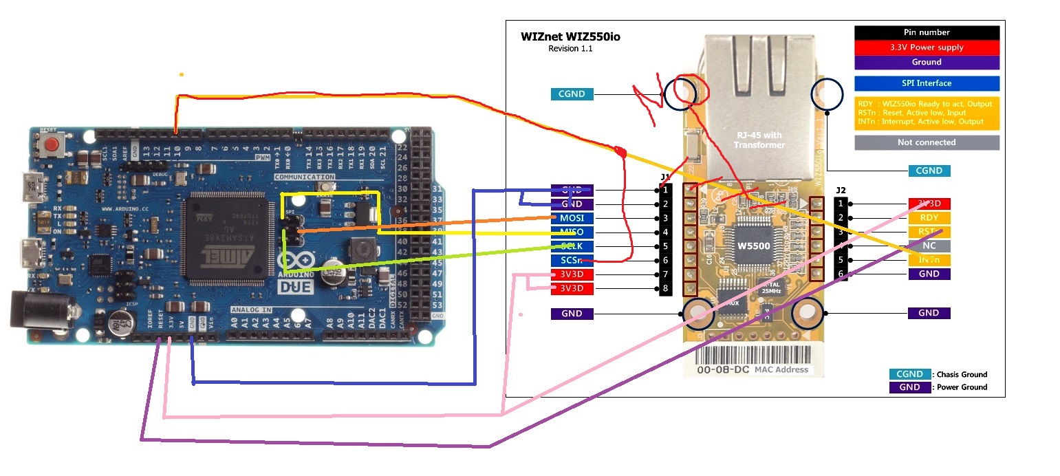

Arduino DUE is linked as :
(I take it but wire is this , we use our custom PCB )

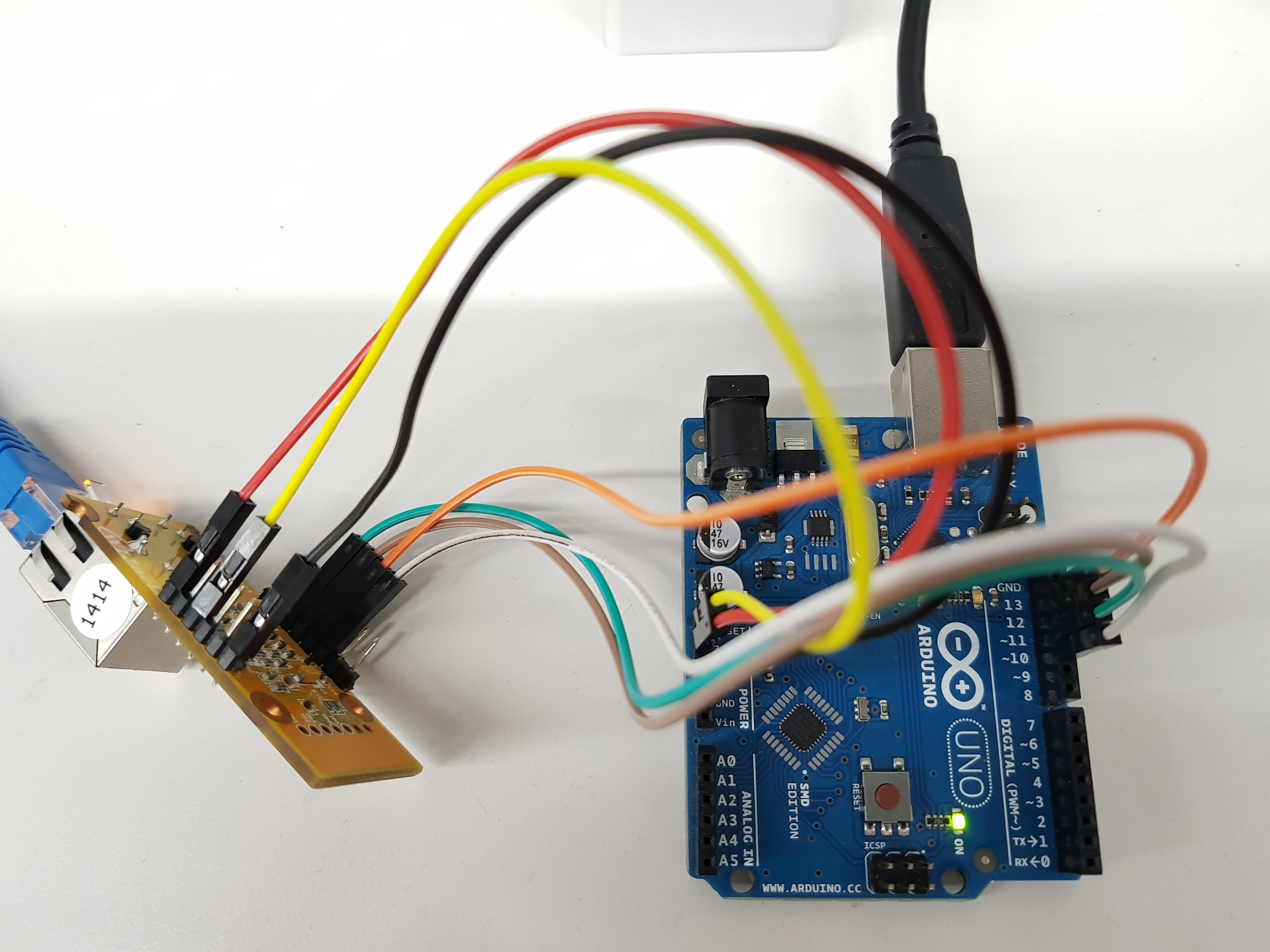

First of all, prepare Arduino UNO and WIZ550io module.
Connect Arduino UNO and WIZ550io module like below.
Arduino UNO pin<->WIZ55io pin
3.3V<->3V3D
GND<->GND
13<->SCLK
12<->MISO
11<->MOSI
10<->SCSn
RESET<->RSTn
I recommand to use ioShield-A.

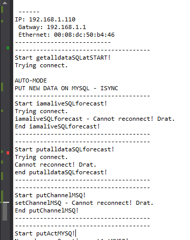

Hi , thank you so much for reply , we need a full working library to work good. We use UDP and mysql connector together and at now ump work so so , mysql no . I send you in private message tracking id of shipment and link with pack test software .
We send to you a sample of our product , composed from Arduino due , zeus board , wiz550io . Thanks and we wait
