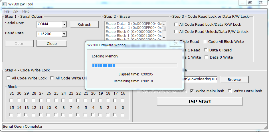

First of all, ISP Tool Operation after Press “ISP Start” is following bellow.
So, if you want to set Flash Option(Lock), you must download firmware at first then, Set flash option.
(because, after Flash lock, you can not upload firmware anymore)

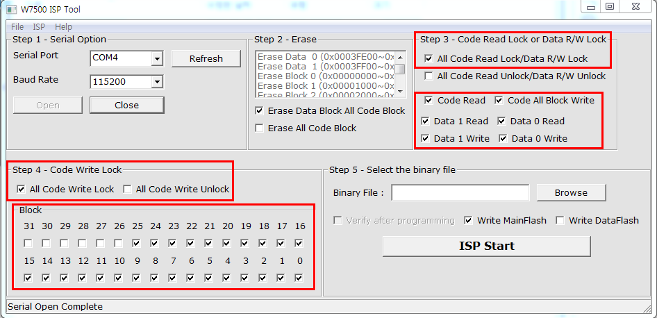

Like These steps!
Select Lock option in Step3,4 and Set Detail Flash Sector as well.

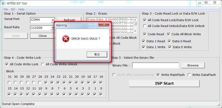

Press the “ISP Start”
You meet the Error message.
But this message means ISP can not Erase flash because it is locked.
(As I said upper ISP Tool Operation, ISP set flash option first then, Erase it)
So, you can pass this message
Now It is locked.
