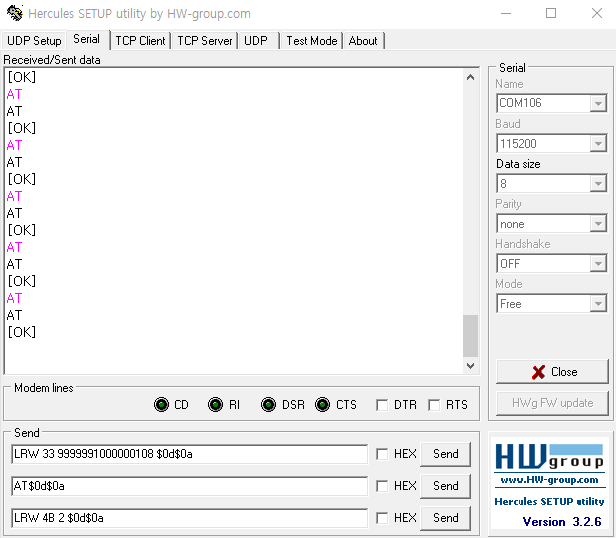

RE: WizFi310 error message
I checked that you said, but there is no problem.
Would you mind adding the screenshot?
I attached the capture below.
Regards

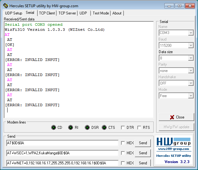

by djdjdjole ·
This is the snapshoot I told you about. Immediately after reset, as you can see
Regards
RE: RE: WizFi310 error message
I guess there is space at the end of ‘AT$0d$0A’ like this 'AT$0d$0A '.
I recommand you do this without space.
If it is not work, let me know then !
Regards,
by djdjdjole ·
Yes, that is the exact behavior when adding space at the end of command. Thanks for support. I am also interested if some firmware revision should be expected, regarding bugs we were writing about in our previous mails ? It is important to me for planing purposes.
Regards
