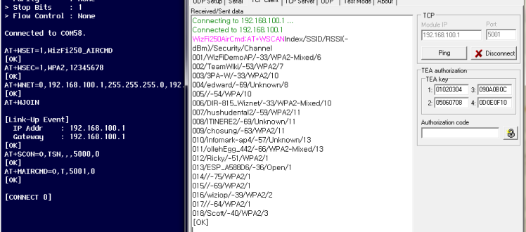

Yes, you can. Use AirCMD. You can refer to following.

I am a bit confused regarding my question number 3.
You say I can send AT commands when in Station mode. I try that and I get no response! Should I connect the wizfi to my home modem , then with a usb to a pc and send some specific command with putty to enable Air Command mode?
In your screen shot you send AT+WSET=1, … which ( 1) stands for AP mode!!!
then you send AT+ WSEC = 0, … which (0 ) stands for AP mode again!!! That confused me! So Air command only works at AP mode?

RE: Data / command mode
by cliff ·
I’m really so sorry.
I misunderstood that.
Air command mode is only currently working on AP mode…
I’m so sorry again to inform you wrong information.
Best Regards
