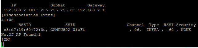

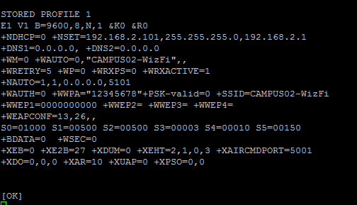

RE: WizFi210 EVB Connection time out
by cgp ·
which firmware do you use and which board?
And the indication of the reconnection of the board is, when the 2 blue LEDs are glow?
What happen, if I am to long out of range with the board?
If the board sends the massage disassociation Event, is it then also possible to reconnect?
I have attached an image of my AT+WS command.
and I attached also an image of my stored profile.
Thanks
