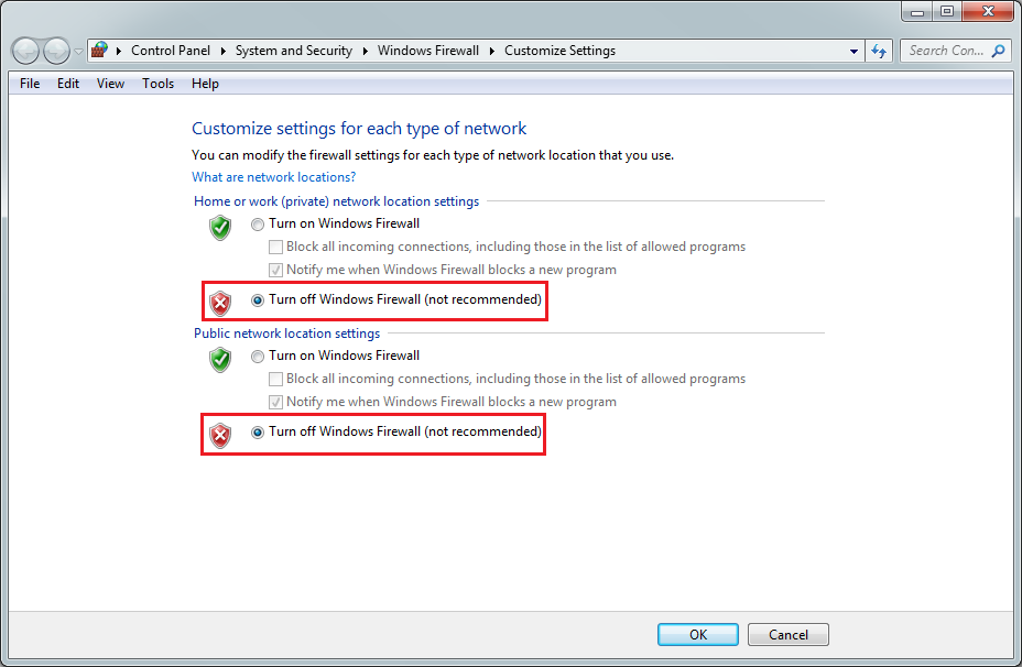

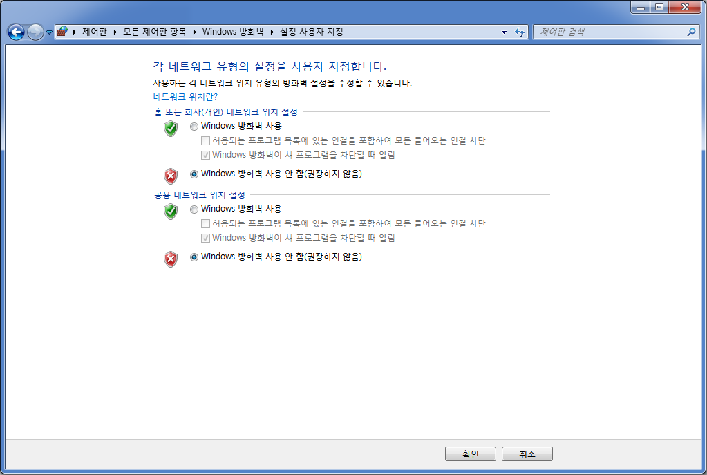

You check RJ-45 Green & Yellow Link LED ?
If LED is on to turn on a fire wall.
Windows7)
Setting is control panel → Windows fire wall → Windows Turn off the firewall. → Off(not recommended) check
Thank you

Did you turn Windows firewall or Anti-virus program on?
First, I guess the firewall caused problem like you. If yes, please turn Firewall off and try re-Search using configuration tool.

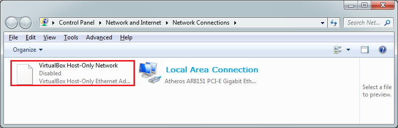

Second, If you use the Virtual machine on Windows (e.g., VirtualBox), Please disabled virtual network adapter for Virtual machines (e.g., VirtualBox Host-Only Network, and Etc.) or adjusted metric priorities for network adapters. There is a possibility that the problem occurs because of Metric priorities.
Please refer to the below information.
