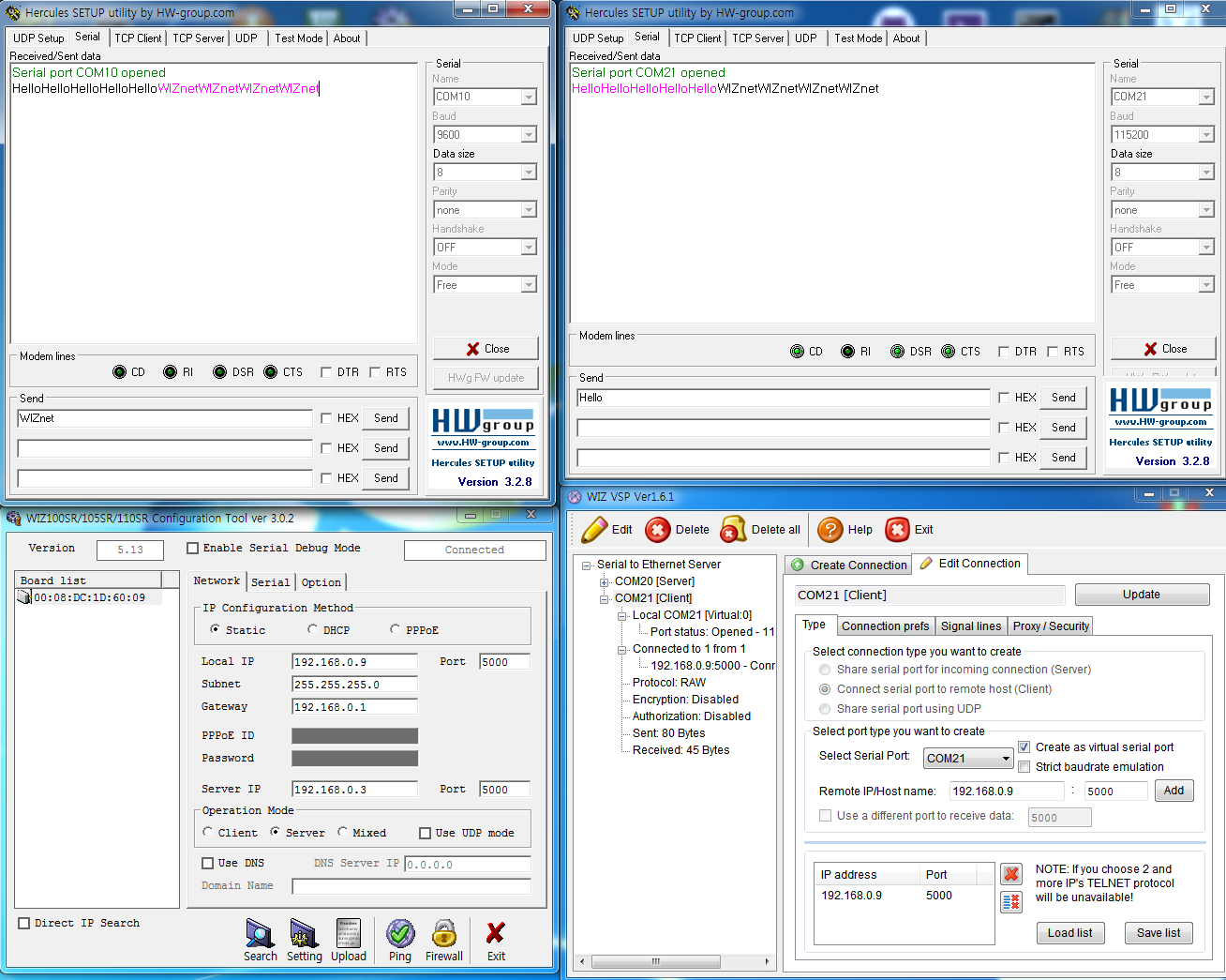

I set WIZVSP software as a client and WIZ110SER as server and this is working good. But I have problem to do it in reverse way it means WIZVSP as a server and WIZ110SER as a client. Could you explain me why it is not working? I did many tests and none was successful. Firewall is not blocking ports for sure because it is working like I wrote at the beginning. What is the reason?
