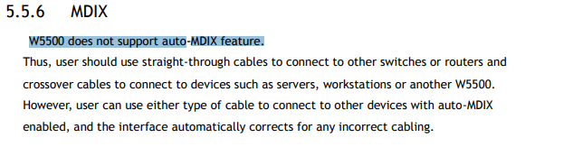

RE: WIZ550S2E Problem with connecting to network
by scarlet ·
Hello, @K-mont , Can you check one more thing?
[Cisco hub supports AUTO MDIX and is set to AUTO MDIX]
The W5500 (W550-S2E ethernet chip) does not support MDIX.
some Cisco products’s default value set to AUTO MDIX.
Additionally, if AUTO MDIX is not supported on the CISCO hub, it is recommended that you change the LAN cable to test. (Cross Cable → Direct Cable)
