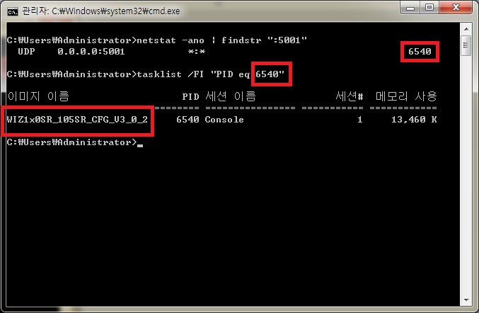

This error is occured when other Windows application is operated with same port.
“5001” port is used on configuration tool.
You can find other Windows application by the following command.
DOS> netstat -ano | findstr “:5001”
DOS> tasklist /FI “PID eq xxxx”
If you find any program, you have to diable that program.

Thanks it worked!
