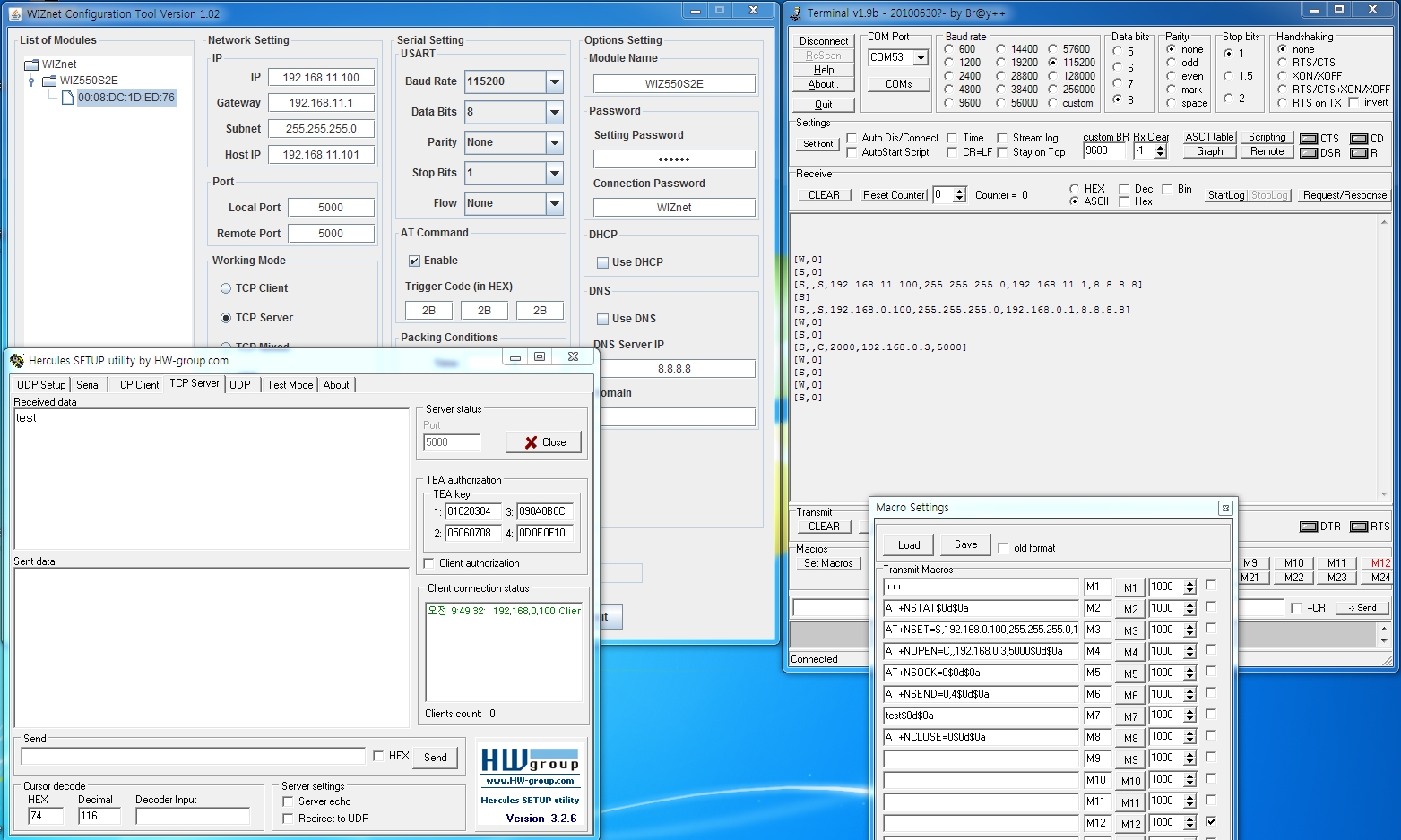

But I see in your example that we have to fill the fields “destination _ip” and “destination_port” in the AT+NOPEN command (“192.168.0.3” and “5000” in your example).
Do we have to fill these fields in all cases with this AT command ? Because with your configuration tool, we can fill the fields “Host IP” and “Remote Port” and according to your documents they represent the “Peer system’s IP address / socket’s port number, which WIZ550S2E connects(or sends) to, when its operating mode is “Client mode”,“Mixed mode” or “UDP mode””
So, as I configured and use my WIZ550S2E module in Client mode, I just want to know if we can get and use these informations filled with the configuration tool when using the command “AT+NOPEN” (send a AT+NOPEN=C, for example) ?
I do not want to store the destination adress ip and the the destination port number in my microcontroller if it is possible.
Thanks

For your exemple, how can the Host IP value (192.168.11.101) can be read with AT command?

In Host IP case, you must use a configuration tool.
There is no command in AT mode for Host IP and port.
