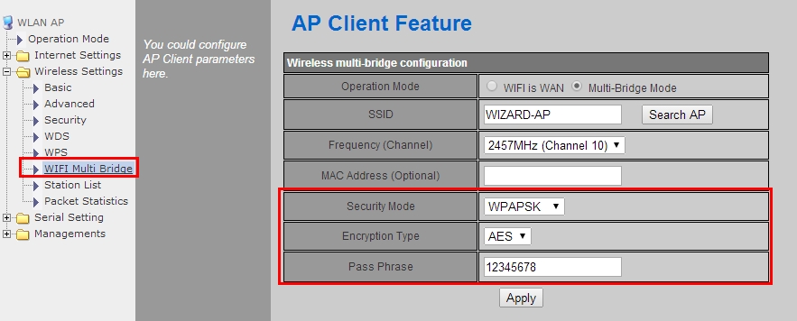

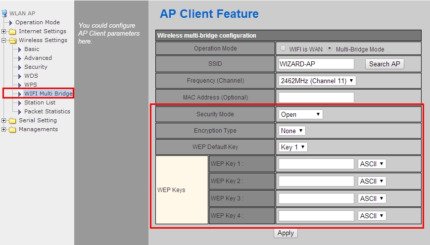

by kaizen ·
Hi
In my test environment, All WizFi630’s setting value are changed after factory reset as well command.
This is my test result. Could you find different you and me?
You can check security value via web browser.
And than issue command. command is Factory Reset command.
And you can see security value which is changed via web browser.
