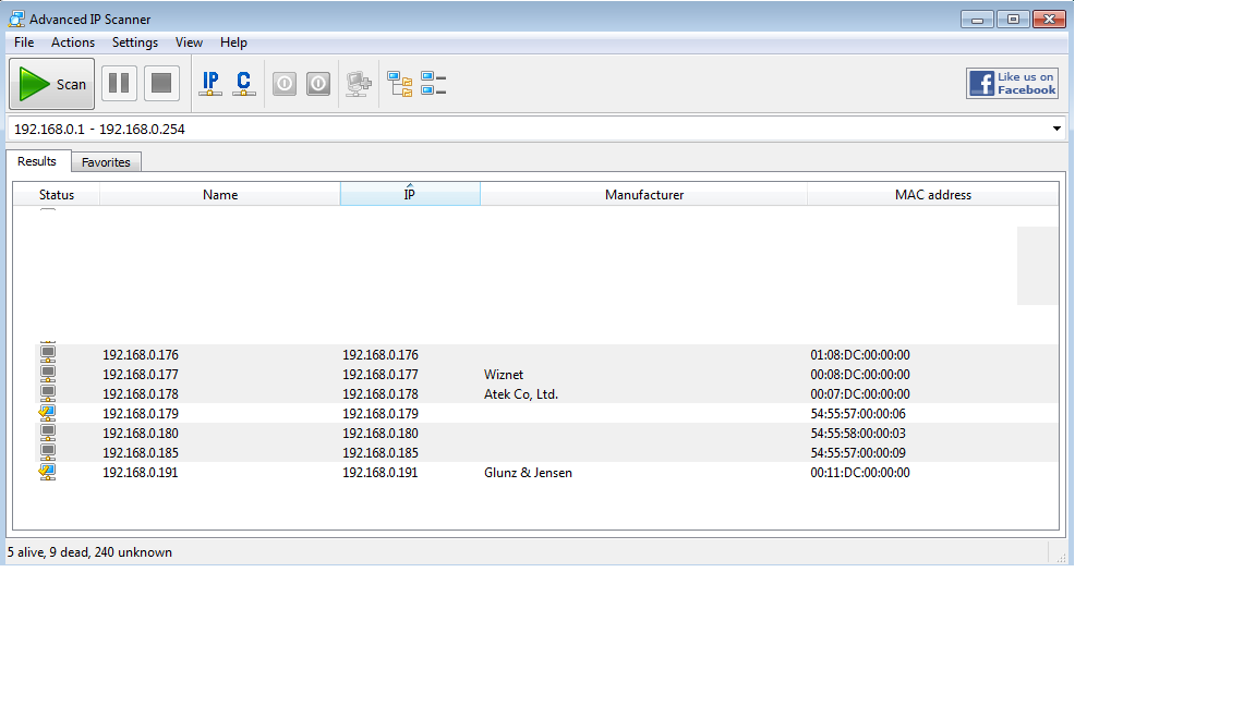

Thank you for reply . I mean the name that can you see next to the IP address after a IP network scan , like in the attached image. With Arduino generated firmware the name is not present but when I use Flowcode to compile the firmware ,the name is present.

I figured out where the problem was. The first three bytes of the MAC address is the OUI (Organizationally Unique Identifier). Because I change the first three bits instead of changing the last three, found all sorts of weird names when scanning IP addresses. For Wiznet the address should be 00:08:DC:xx:xx:xx .
