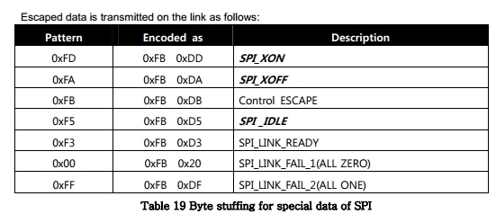

RE: [From QnA]MTU size, s2w data packing and s2w data overflow
by wieser ·
Yes, but we were planning to use spi.
by ssekim ·
Hi Wieser
I think there are 2 available options.
Using SPI S/W flow control
Flow Control as application level
It means that doesn’t send a next data until receiving a <recv ok message, a kind of Ack> from .
