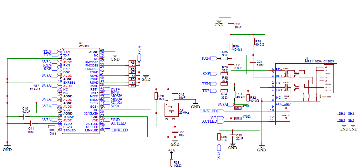

I have same issue but in my it links fine when i reset pic18f46k42 2-3 times or when its in debugging mode or when pickit is connected to pc on boot it auto reset but when pickit is not connected it sometime links sometime doesnt if you have found any solution please help

Hello
I would appreciate it if you could send the schematic to alan@wiznet.io. Thank you.
