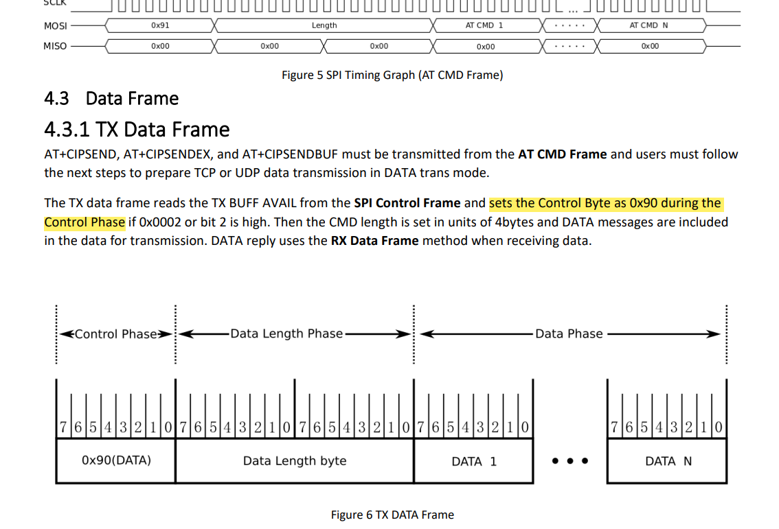

Hello, thanks for your answer.
I must mention I’m doing it via SPI. According to documentation a TX data frame is required to send data.
RE: About data frame 0x90
Hi @abalore
When using SPI to send data, please set 0x90 in the control phase as mentioned above.
There is a WizFi360 SPI example, so it would be good to refer to it.
