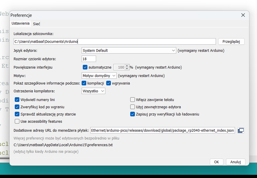

I added “Additional Boards Manager URLs” field

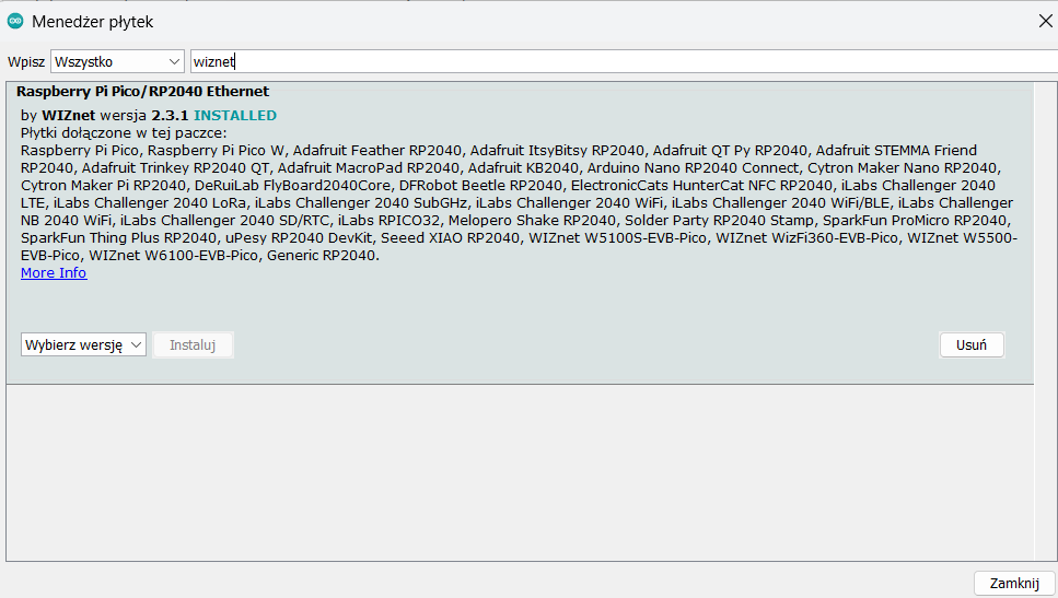

I installed library by wiznet

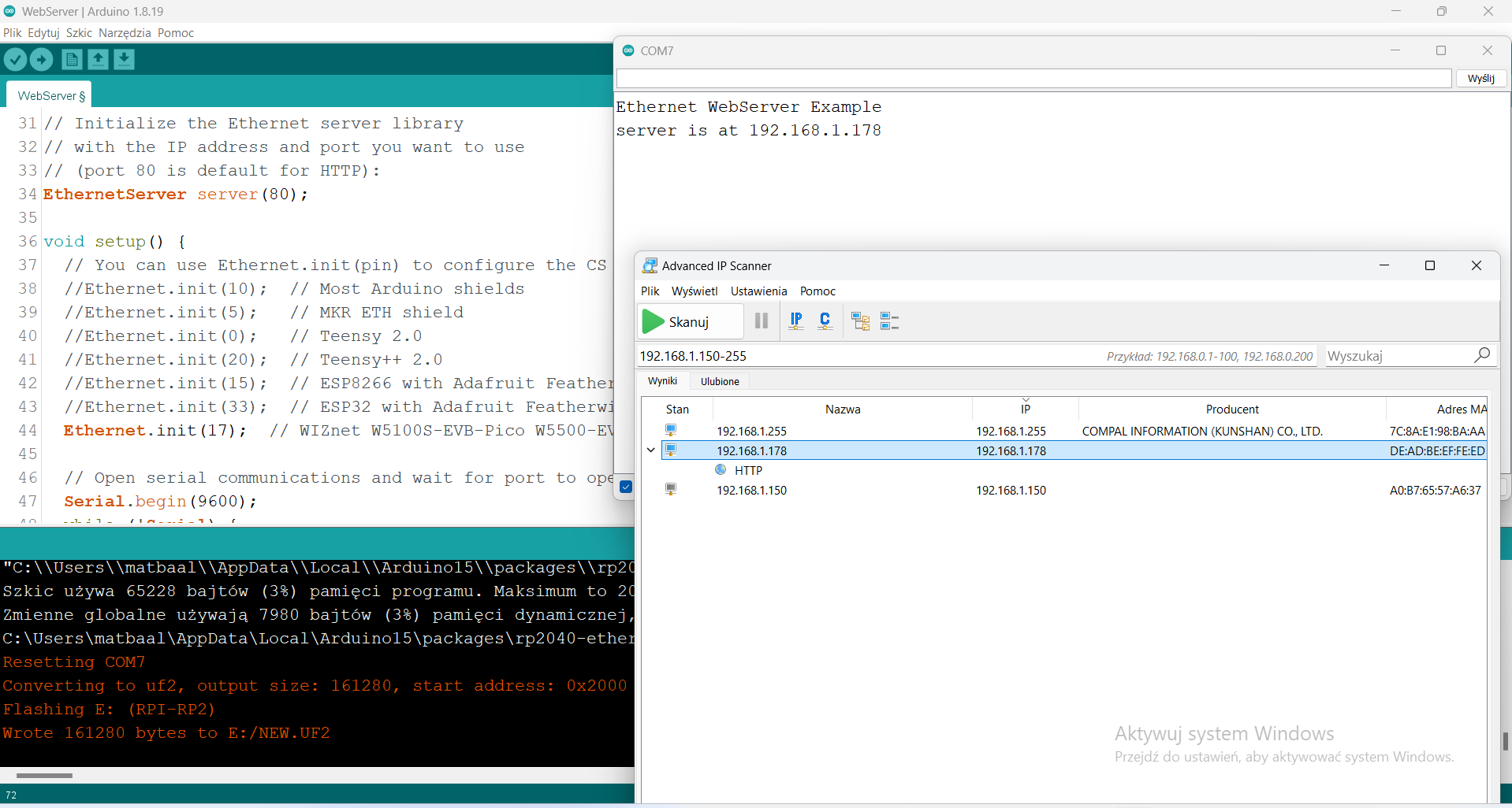

I’ve tested default examples blink and WebServer examples
