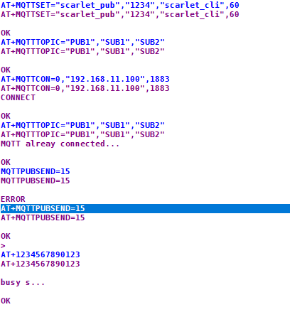

First of all, [MQTTPUB] is a command used for general strings.
It is correct to use the [MQTTPUBSEND] command for binary data.
I am attaching the screen that I tested here.
It appears that you have written code to send a message from the MCU via UART.
If you’re using a module, have you tried sending commands using a serial program (ex. tera term)?
When developing with WizFi360, we recommend verifying the command transmission process with a serial program before proceeding with development on the MCU side.
If there’s an issue when testing with the serial program, please attach the log and feel free ask to me.
