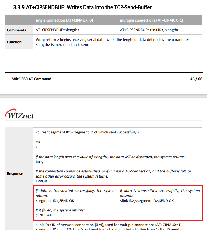

Hi @AndreyS
When data is transmitted using ‘AT+CIPSENDBUF’, if the data is successfully transmitted, it responds with ‘,SEND OK’ or ‘,,SEND OK’.
In other words, please check the ‘SEND OK’ response and enter the next AT command.

Hi @austin
After sending the data for the
"AT+CIPSENDBUF"command, the message"<CR><LF>Recv <len> bytes<CR><LF>"arrives. Why doesn’t the document “AT Instruction Set” say anything about this message?The message
"SEND OK"means that the receiving side of the TCP socket has confirmed the receipt of data?Do I understand correctly that after sending the command
"AT+CIPSENDBUF"and receiving the response"<CR><LF>Recv <len> bytes<CR><LF>", you still need to receive the message"<CR><LF><segment ID>,SEND OK<CR><LF>"or the message"<CR><LF>SEND FAIL<CR><LF>"before sending a new AT command (including"AT+CIPSENDBUF")?RE: Asynchronous messages are wedged into any place of synchronous messages
Hi @AndreyS
That information seems to be missing.
I’ll revise and reflect this issue in a later document.
‘SEND OK’ is returned when data has been successfully sent.
Yes, you understand correctly.
The received data contained the ‘AT+CIPSENDBUF’ response and return value, which told me this was the problem.
Is my understanding correct?
So, to avoid this problem, I replied to check the ‘SEND OK’ or ‘SEND FAIL’ response and enter the next AT command.
If you want to do data buffering, you need to implement the application considering that the response and return value of ‘AT+CIPSENDBUF’ is included in the received data.
