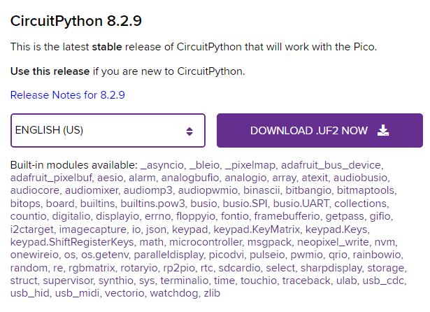

This is an update to CircuitPython for W6x00 series support.
The usage is the same as the existing WIZNET5K library, and unfortunately it only works with IPV4 and not IPV6.
This version has been tested on CircuitPython F/W 8.2.9 and you can use all the examples on Github.
Please try it out and let us know if you have any issues.
https://downloads.circuitpython.org/bin/raspberry_pi_pico/en_US/adafruit-circuitpython-raspberry_pi_pico-en_US-8.2.9.uf2
