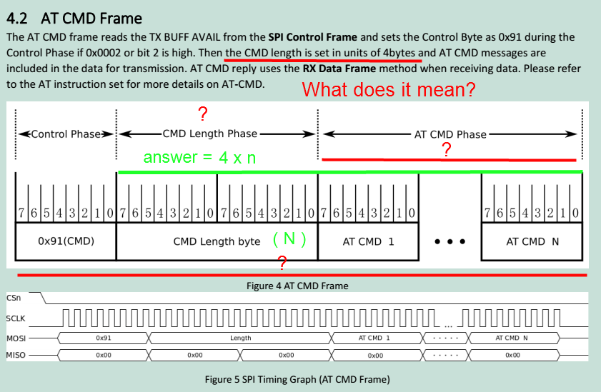

WizFi360 with SPI, sending CMD command like AT
RE: WizFi360 with SPI, sending CMD command like AT
Hello @lentec
AT CMD Phase should be set in units of 4 bytes.
For example, when sending ‘AT’, the AT CMD Phase should be filled with ‘AT’ and the remaining 2 bytes should be filled with dummy data.
In this case, fill in the CMD Length byte with 4 bytes length information, which is the value of ‘AT’ + dummy data length 2 bytes.
The link below is a WizFi360 SPI example, so please refer to it.
by lentec ·
I have found this:
WizFi360-SPI-to-Uart-in-Nucleo-master\Src\main.c, lines: 582-587
TX_len = len + 2;
and it works on many AT instructions. So, the answer is:
