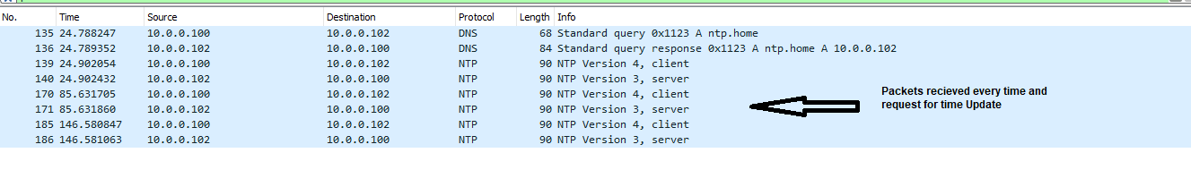

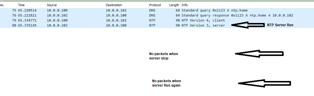

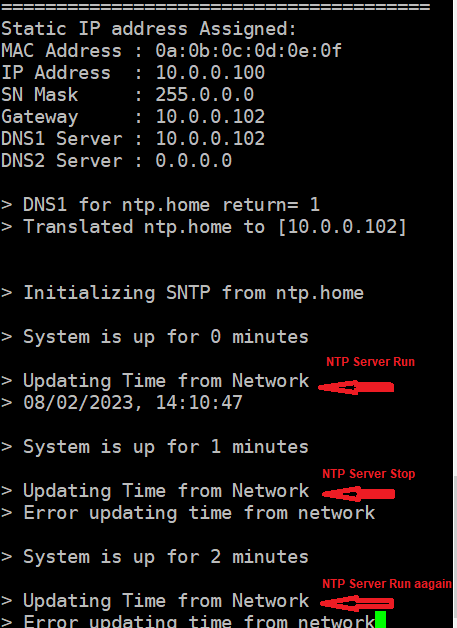

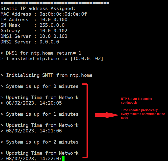

Here I am attaching the code. I use the original files in ioLibrary_Driver.
Also, I am attaching snapshots for the two scenarios (When server run 1-continously and When 2-Run/Stop/Run)

Thanks. The routine is very small and simple, instead of guessing what is wrong put diagnostic output after each command displaying the stage it is in (what command is going to be executed) and result of previous command. i am sure you will get what is wrong very quickly
