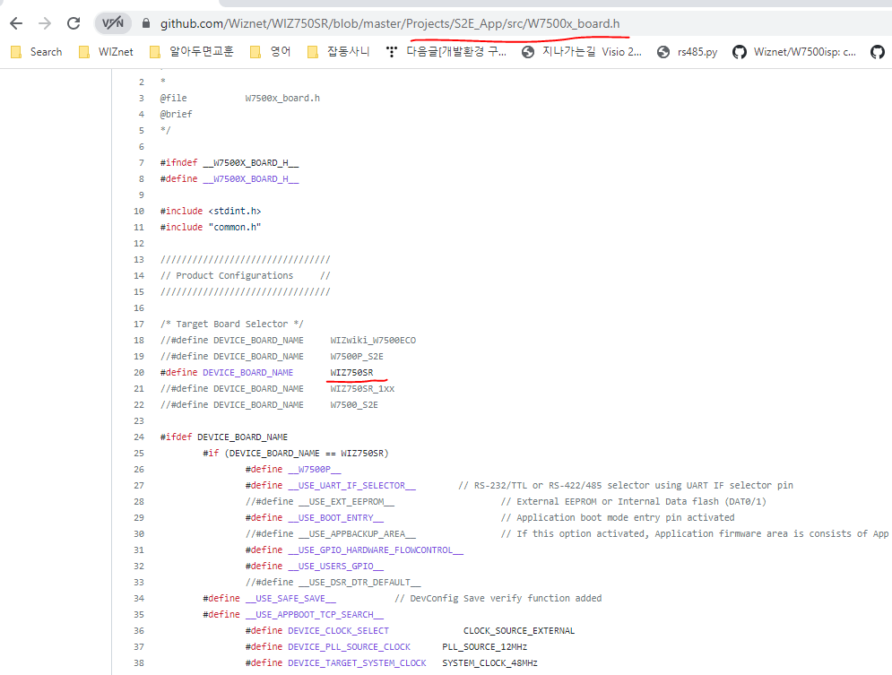

If you want to change the Device name and MAC Address, you have to modify the firmware of WIZ750SR.
To change the MAC address, you need to change the source code of Boot and app and you should erase the Data memory area using the “w7500 isp tool”.
The first three digits of the MAC address (0x00/0x08/0xdc) are appended to IEEE to indicate WIZnet. So you view ethernet packets the name wiznet appears.
If you erase data memory area using “w7500_isp Tool”, you can view the message(Click on the below link) in the serial tool
You can change DEVICE_BOARD_NAME to anything you like in W7500x_board.h.

To change the MAC address, you need to change the source code of Boot and app .
→ What this means is…You need to compile the source code.
If it complete you can obtain the a *.bin file, it should upload through your ISP.

Then for changing the device name, how would I upload this w7500x_board.h file, is it a firmware upload through the config tool?
→ Same as answer 1.
