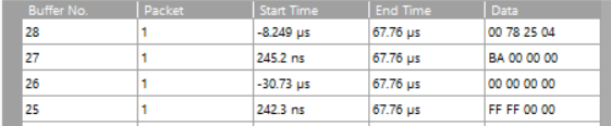

Tested CLK, MOSI and CS all on the Wiznet W5500 pins and they are all getting to the chip, just no MISO signals are being sent back at all
RE: No Miso response when trying to read register
by Matt Danecca ·
If I wait till CS line is pulled high before powering the Wiznet chip I get very occasional MISO data. I am sending the read command and get these 4 lots of 4 bytes randomly, maybe every 10-20 seconds:
Same values everytime it does happen
