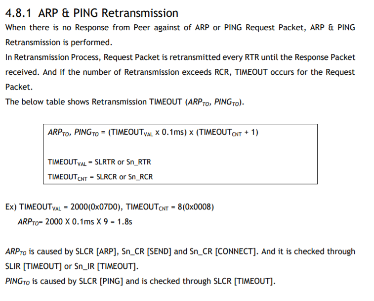

Hello.
RTR sets initial value of Sn_RTR (SOCKET n Retransmission Time Register). The unit is 100us.
RTR and RCR (Retransmission Counter Register) set ARP & TCP Retransmission.
