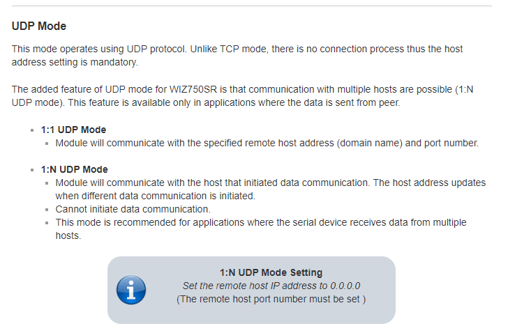

RE: WIZ750SR-100 second socket refused
I think you are half correct and half not.
It is possible to connect UDP socket from two different PC but it is impossible to read the serial data from two different PC.
Please refer to document as below
https://wizwiki.net/wiki/doku.php/products:wiz750sr:usermanual:start
