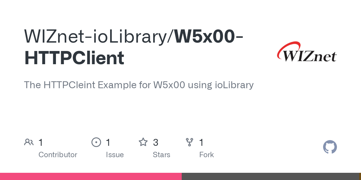

As far as I know, we not support the HTTPs Application.
This link is the example of HTTP client using W5x00(iolibrary).

this example on HTTPclient but i want to implement HTTPS client, just to send data to server.
so HTTPS client is not possible in your device?
