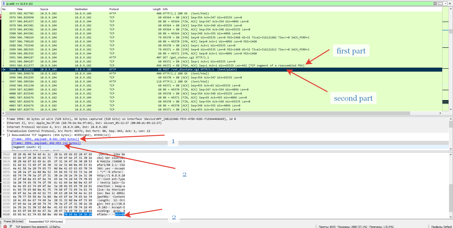

Thank you for reply @Eugeny . I discovered that problem appeare when I connect to http server on w5500 from ios device. Chrome on IOS device have the same problem. But safari on Mac book work fine. I did not write recv function. I just take it from wiznet http server library. IOS tcp stack may be split in 2 packets ajax request. Where I can read full size of http packet?

The problem is not in library, it is in logic of your code. Library returns data or pointers available at the specific time, but it is your application logic to decide if that you have received is a complete data, and you must go to
recvfunction again and wait for more information (with timeout of course). For example, HTTP response ends with CRLFCRLF, and whatever number of times recv returns with data, application must call it again until receives this magic sequence, only after this HTTP response is deemed complete, and application will base its behavior on the contents of this HTTP response. Before this full data receive happens, HTTP response data should be considered as invalid.RE: Safari on IOS ajax request in segmented frames

@Eugeny what size receive recvsize = getSn_RX_RSR(sn); when the first segment of packet received?
Only size of first part (segment) ? After that i must parse http packet and decide does i need another parts of http packet ? and call recv function to catch rest of data?
I suppouse that packets with relative sequence number glued in wiz buffer because http is 7 level, may be i am wrong?

Normally yes.
Correct.
You do not deal with “packets” if you use socket in TCP mode, you just deal with count of bytes in the buffer and the data in the buffer.
