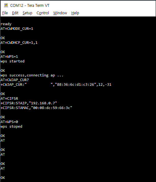

I tested the “AT+WPS” AT command in Station mode and SoftAP + Station mode, but UART1 didn’t dead.
Could you tell me the test information about test environment, log, firmware version, etc?
And UART1 can upgrade firmware too.
Try upgrading firmware with UART1.

RE: WizFi360 - WPS issue
First of all, I tested using version 1.0.7.5 firmware.
Could you try after updating the firmware to version 1.0.7.5?
And tell me the test sequence how you tested it.
I will test it too.
