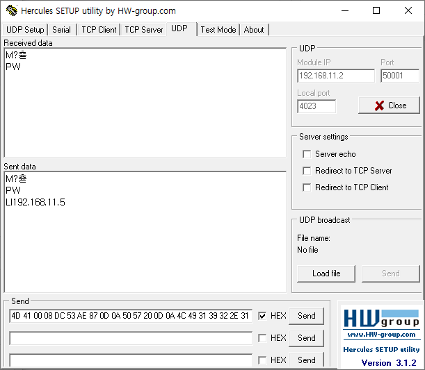

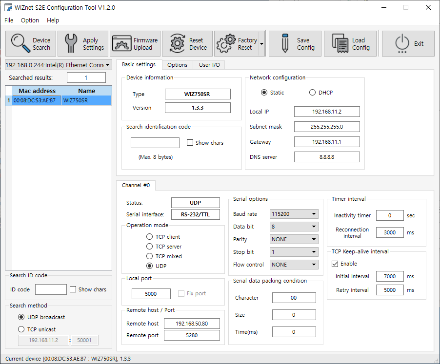

Hi Swapnil.
I have tested it. But it works well like below.
