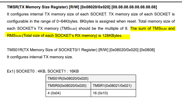

What is this? Is it the Sn_TX_FSR register?
Do you mean you set 0x3020 in TMS01R?
This is set to 48 bytes for socket 0 and 32 bytes for socket 1.
Have you set the registers in accordance with the above?
You set the memory of socket 0 TX and socket 1 TX to 80, so the sum of the memory of the remaining sockets should be 48.

i set various size for TMS0 Register(and x"30" is one of them) but same problem is remain for all of sizes.
