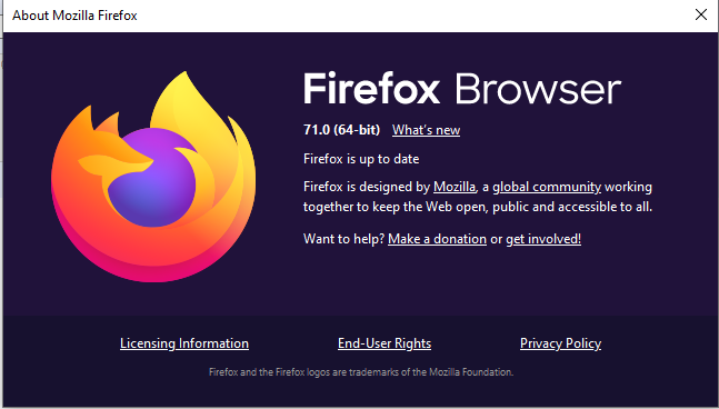

I am using Firefow Browser 71.0(64-bit)
Are you different from you?
If so, please let me know what are you using.

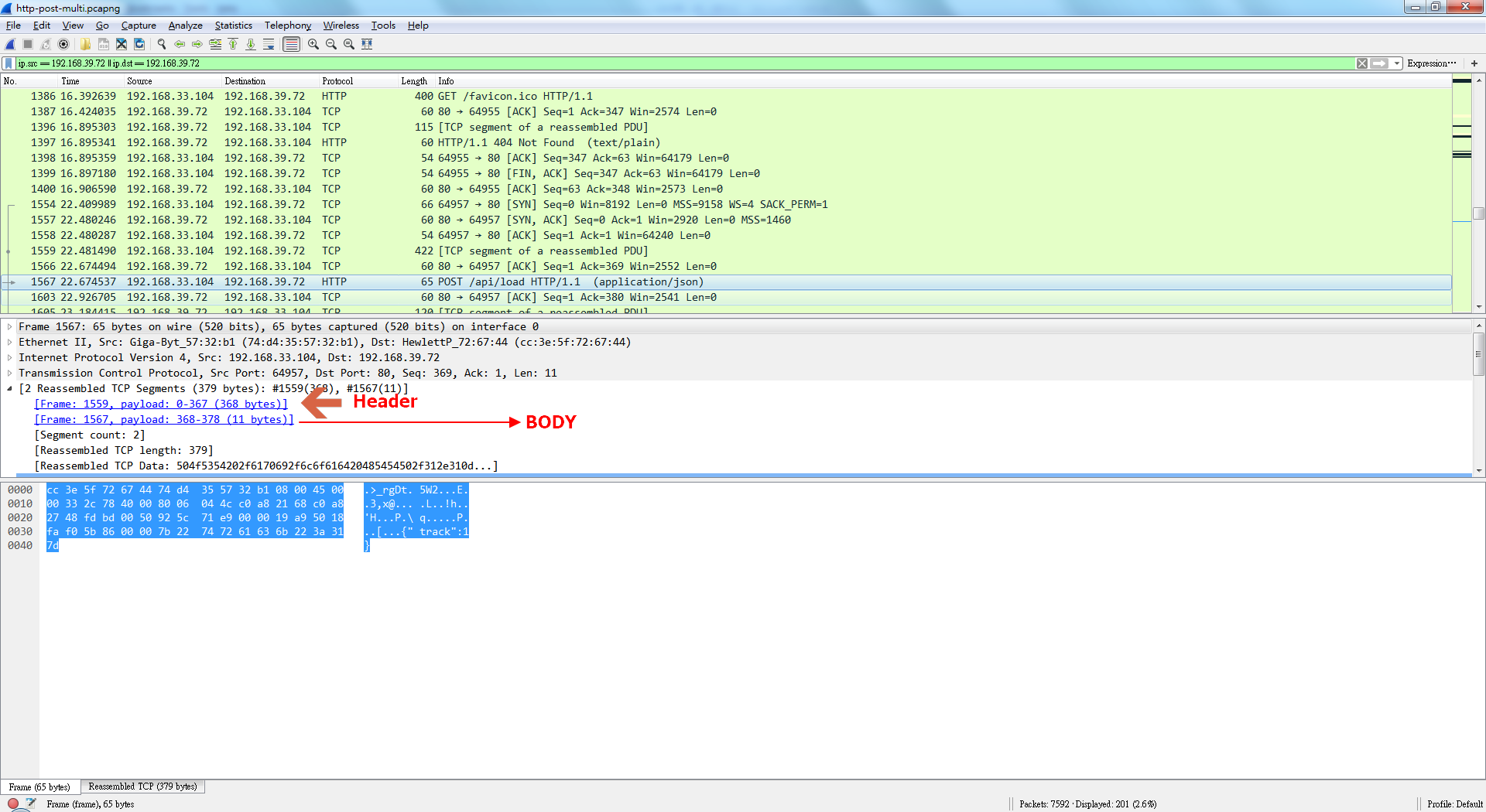

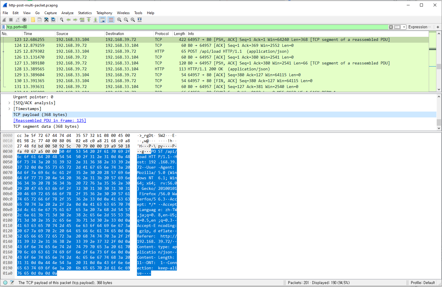

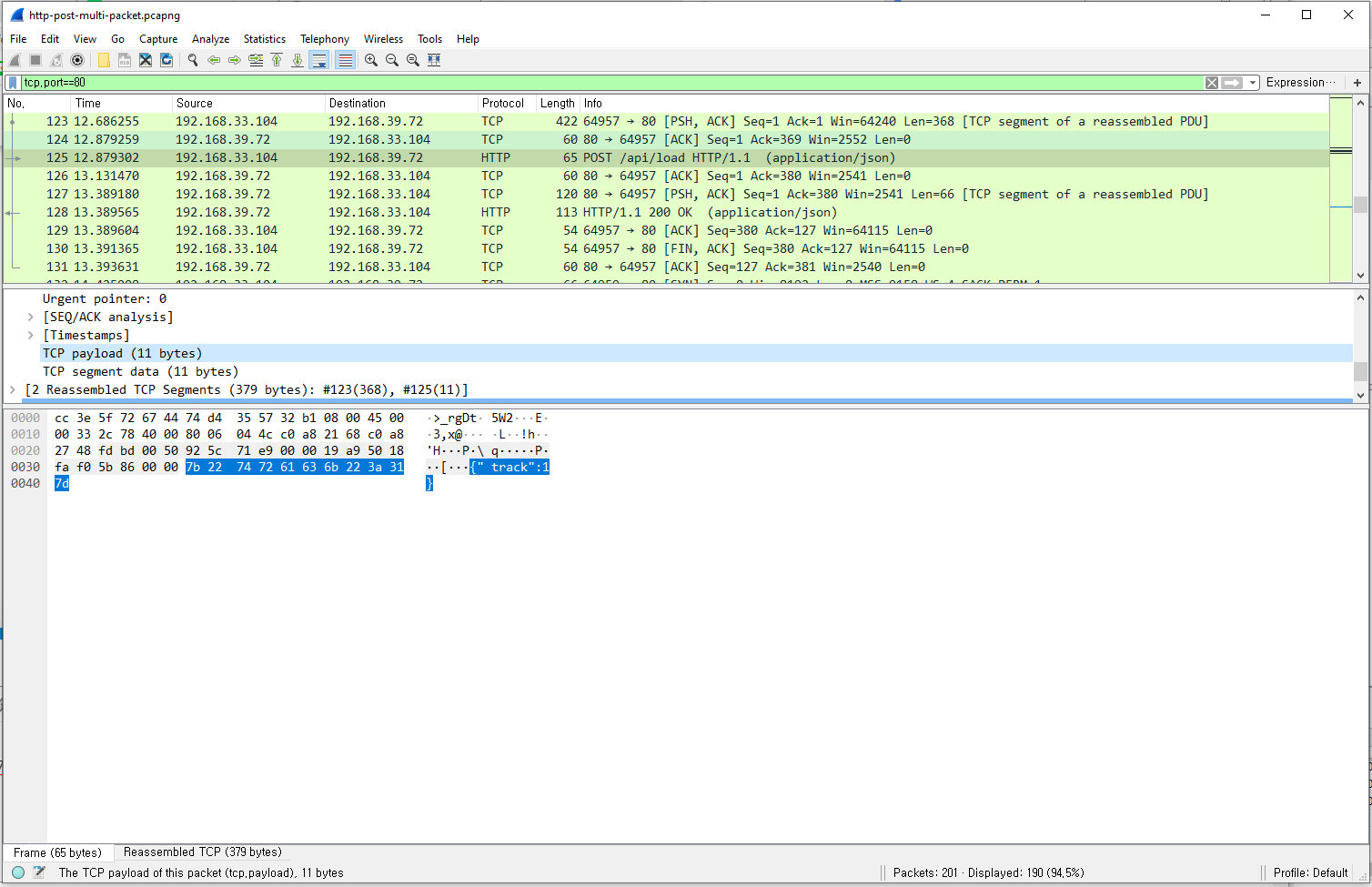

@becky I am sorry, my fault. In WIN10, chrome and Firefox works well. The problem only happen on WIN7.
Please see below picture, Http protocol become two package.
You can download complete Wireshark log file from:
Please open the log file by 2.2.5 or latest version.

In the packet, the HTTP packet is split into two as you say.
W5500 receives and processes TCP payload as data.
After receiving the first packet, it is likely to add a code that waits for the reception of the data based on the content length.
