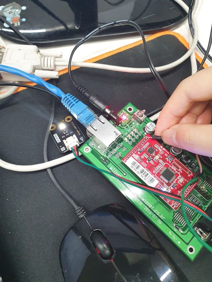

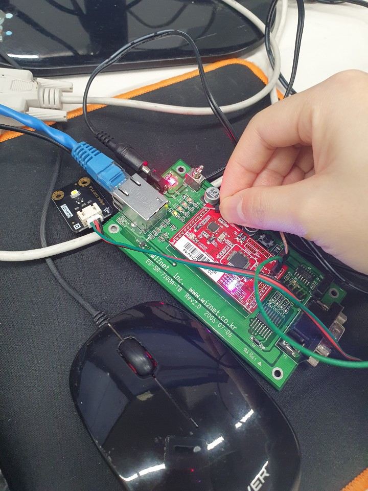

I tested it.
Set GPIOA to HIGH
SENT :
RECEIVED:
Set GPIO A to low
SENT :
RECEIVED:
It worked.

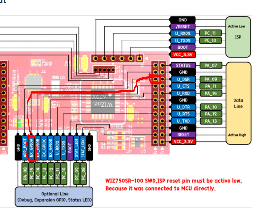

So I hope you check the GPIOA pin once more.
