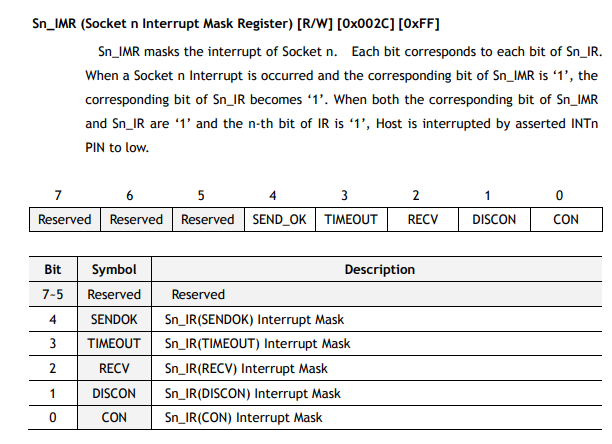

No, it is not possible on the W5100. If you’re using the W5500, that’s possible.
The W5500 has a Socket n Interrupt Mask register.
If you need to use W5100, I think you should check Sn_IR every event.

When I dig into lib. I found that this function clears “IR” register [0x0015] not “Sn_IR” register and I think the data sheet states that you should clear “Sn_IR” register which will clear “IR” register automatically. Is this really a mistake in the library or I miss something?
I did a direct clear command to “Sn_IR” and it works, the interrupt cleared.
