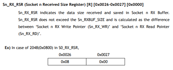

I believe this line is reading the received data size from the particular register . But i dont see any data receiving command before this.
RE: Loopback test
Check the size of received data through getSn_RX_RSR and receive the data through recv () function.
