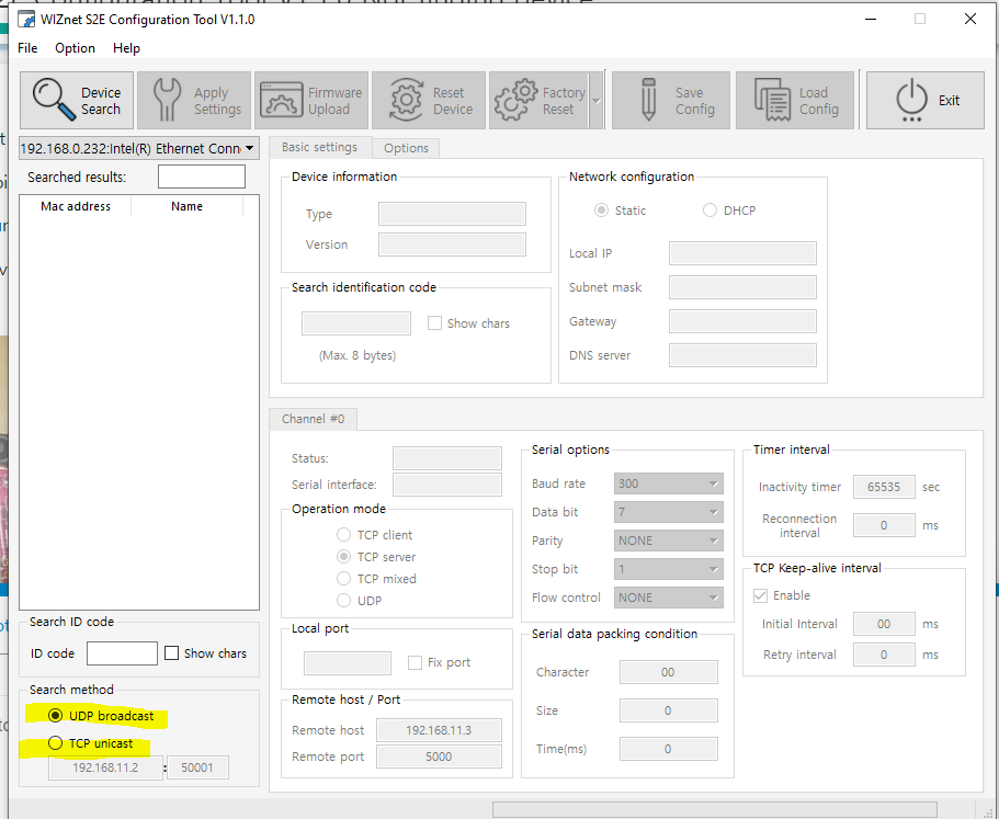

WIZnet S2E Configuration Tool V1.1.0 Not finding device
RE: WIZnet S2E Configuration Tool V1.1.0 Not finding device
Is your PC connected to the same network as the WIZ750SR-110?
Please change the search method to TCP unicast.
by rena ·
Hello, @karen.
There are several reasons why the config tool does not find devices.
Please refer to the below link.
@karen
The attached figure is WIZ110SR, not WIZ750SR-110.
If you use the product of attached figure, you have to use another configuration tool, which is different from WIZ750SR-110.
Link : WIZ110SR Configuration Tool
But if you use the WIZ750SR-110, please refer to the troubleshooting guide provided by @rena .
by karen ·
I apologize for the confusion regarding the model number. I was provided the wrong information for the card when it was delivered to me. Now I realize I had the wrong config tool. I was able to connect once I installed the correct tool provided by irina_kim. Thank you irina_kim
