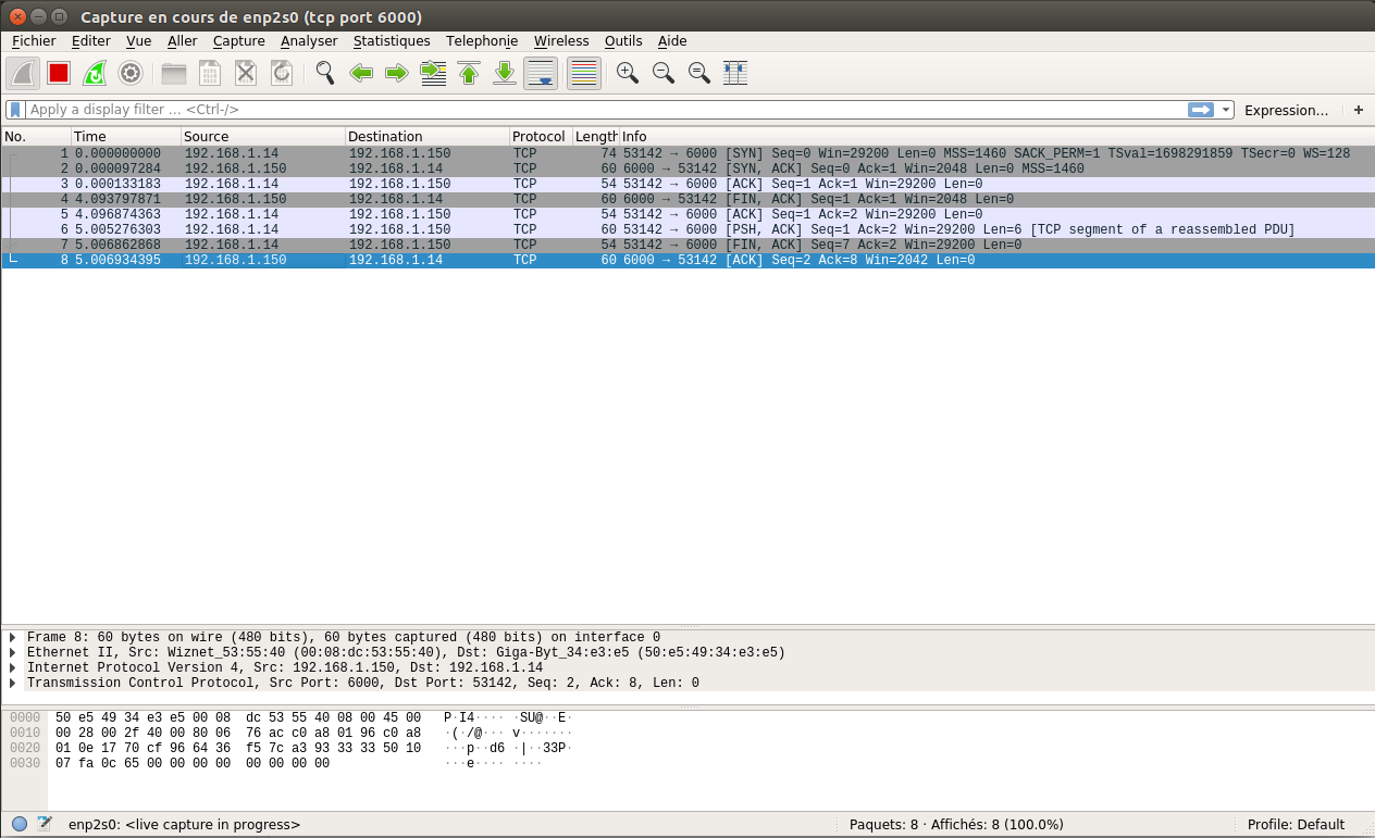

FWIW, here’s a screenshot of the packets captured by wireshark when I run the sample code:

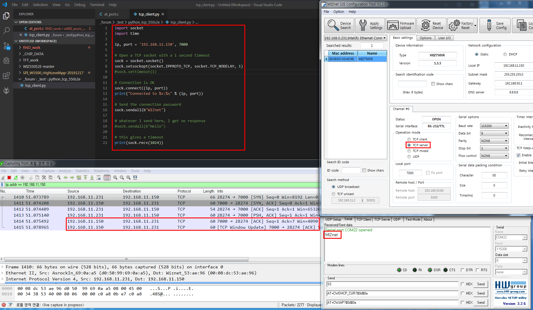

the below capture is the test between python and 750s2e.
you can check the data from uart terminal.
thank you

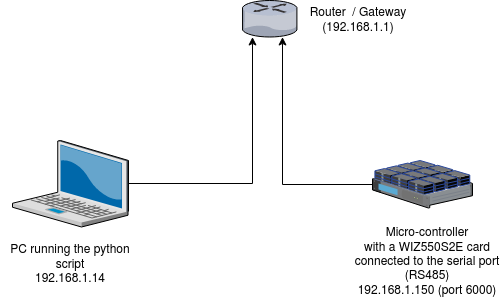

I realize I wasn’t very clear on what I’m trying to achieve.
I’m writing a software (running on a PC) that want to send and receive packets over TCP to a serial based software running on a micro-controller with a WIZ550S2E card connected to it’s serial port, so the communication should be bidirectionnal.
Here’s a diagram:

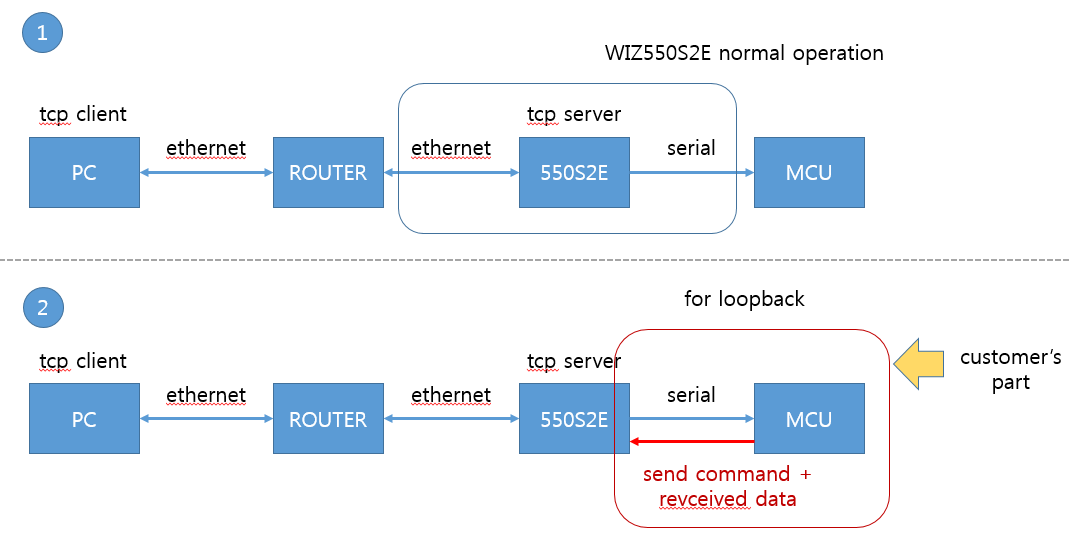

First, I would like to check what you have done for tcp loopback.
I put the picture for explaining WIZ550S2E normal operation and what customer have to do for loopback.
Basically. WIZ550S2E only bypass tcp data to serial data. And… that’s it.
If re-send the received data from serial, mcu must control WIZ550s2e to send the data with send command.
Could you check how the red part you have done?
thank you
