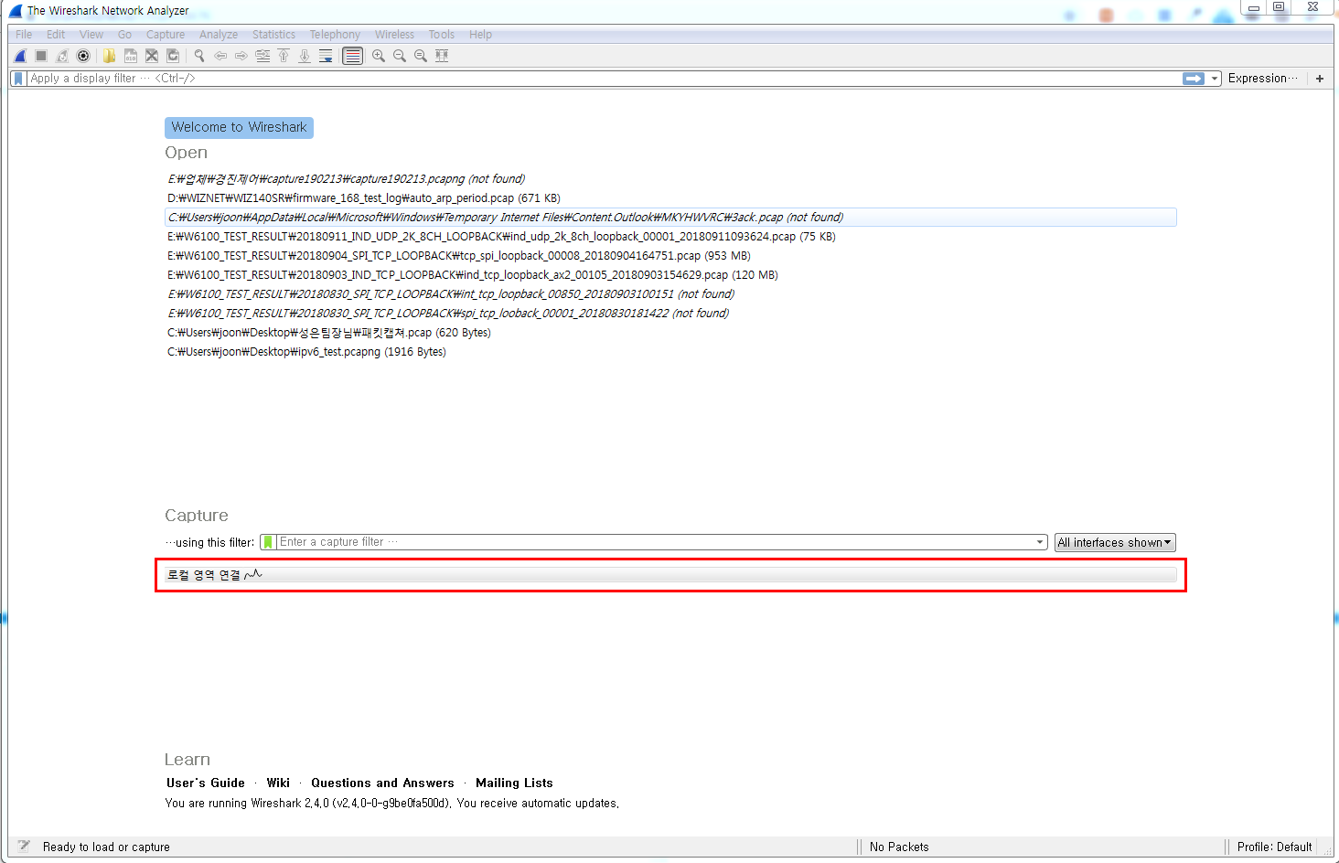

Can you check one more with wireshark?
This is open s/w for check all internet packet.
https://www.wireshark.org/download.html
I tried to make the same case with you but could not.
After install the wireshark, please follow below simple guide.
select your internet adapter
filter your peer ip & tcp
ip.addr== peer ip && tcp

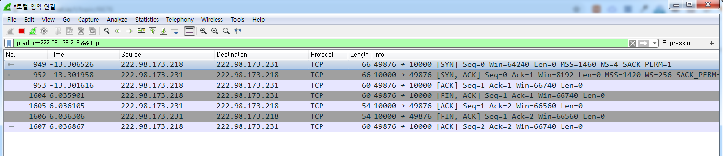

Could you try again with the close command weather there are FIN packet or not ?

Thanks @lawrence, I found the problem as follows:
When I use “close” command for closing TCP connection, the connection really closes but the server side do not figure it out (not only my app, even windows do not know). So when I try to make new connection using “connect” the server suddenly knows closing and opening connection in same time, so my app (using C# async) think that the connection is closed and throw an exception.
When I changed the command from “close” to “disconnect” it let server to know that the connection is closed so the problem solved (before I was used “disconnect” command after “close” command so it does not work correctly).
