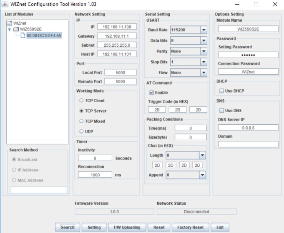

TCP Sever 모드로 동작 할 경우 Clinet 측에서는 접속후 최초 접속 비밀번호를 전송 해야 합니다.
해다 비밀번호는 기본값으로 “WIZnet” 입니다.
상세 내용은 아래 링크에 Password 단락을 참고 바랍니다.
https://wizwiki.net/wiki/doku.php?id=products:wiz550s2e:wiz550s2epg_kr#configuration_tool

I used to have some S2E modules with version 1.0.0 and had no issues with them, I recently bought some more but they have version 1.0.3 and now im having connectivity issues. I tried to downgrade to version 1.0.0 following your video but it didn´t work out. Can you help me out ?

Hi.
Please check the following again.
Ex) If the PC is 192.168.0.2, the module is 192.168.0.xxx
If not,
Add. 1.0.3 is a better version than 1.0.0. We recommend using version 1.0.3.
What is the connection issue? If the module is acting as a server, the client must send the connection password first after connecting to the module. Did not you forget this?

Just remove the password for both connection and the module. This will work fine.
